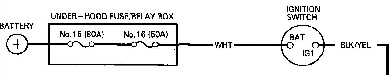

White wire to the ign switch.....what is the voltage reading on it?

I'm using a test light it shows no power to the white wire
Old Feb 27, 2013 | 08:13 PM
Then there is one more fuse in the underhood fuse box you need to check with your test light/volt meter.....#15 80 amp (amp depends on trim level, I think?).

This fuse is good is there maybe a relay that is bad

Just to clarify in my mind when you say the fuses are "good" are you basing that on just a visual inspection or are you testing both sides of each fuse with the test light/ DMM?
Old Feb 27, 2013 | 08:54 PM
  #17
No relay is bad that is causing this.
There are two fuses that lead to the white wire....we started with #16, before that is #15 (80 amp ?). So what are the readings on it?
Do the headlights work?
Something like this for the power going to the white wire on the ign switch?
Attached Thumbnails 92 accord lx has no power to inside fuse box-4th-gen-ign-sw-input.jpg
