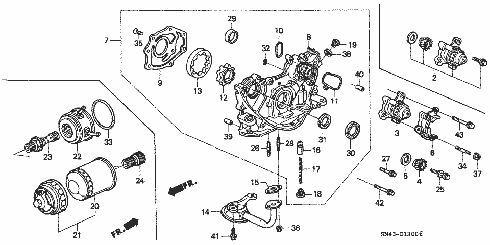

There's 2 plug/bolts on the back of the engine block, above the oil filter. One is coolant, one should be oil. Can you get a good look (from underneath?) to convince yourself whether that's leaking? Clean it good then wait for it to leak some more? I'd want to be sure before I opened anything up.
Sticking out from the oil cooler is the pipe nipple that the filter screws onto. THAT goes clear thru the cooler & holds the cooler onto the block. Look for a relatively large hex to put a wrench on that thing. Then there's an O-ring between the cooler & the block.
Attached Thumbnails 92 Accord oil leak not pressure switch. Maybe oil cooler?-1992-oil-pump.gif
