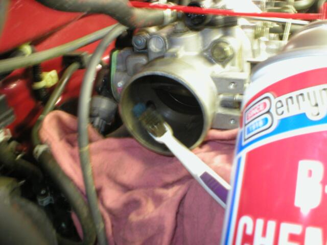

I'd say to try a throttle body clean, get a can of Berrymans B-12 and a toothbrush.
Remove the air tube and scrub out the ring of crud around the throttle plate.
also pull off the IACV and spray out the carbon build up from the screen.
You also might want to check the Vac advance.
Attached Thumbnails 92' Runs rough when warmed up HELP PLEASE!-thttlebdycln.jpg
