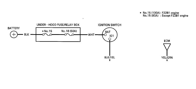

Old Aug 25, 2012 | 11:33 AM
If the white is not hot (12v to ground) at all times.....then yes trace it back.

Dome light works....Doug in under dash and found a mess: prior owner put in a remote start! So there are wires and splices and in-line fuses all over...I quit for awhile as it was overwhelming!
Old Aug 26, 2012 | 04:29 PM
Frank Ploof's Avatar
Joined: Aug 2012
Posts: 5
This morning after chasing power back I found that in fact the 50a fuse had blown...I replaced fuse and reassembled all and now everything works....so I'm back to wear I started!! If I end up needing an electrical Ig Sw, I can now do in about 10 min.
