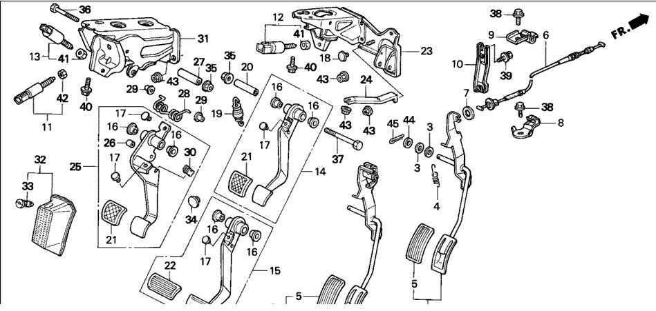

What does the other clutch pedal switch do? The one that stays pressed when the clutch is released? Cruise control disconnect?

There is only one clutch interlock switch which is integrated into the cruise control system as well. If you are talking about the one with the bolt that is the clutch switch adjusting bolt.
Ah, I have to say this isn't correct. In a 5th gen Accord with a manual trans there are TWO switches on the clutch pedal.

Not According to my 95 Accord wagon 5 speed sitting in my driveway or the Honda shop manual. It being a 94 there is the potential of a cross over/carry over in parts from the previous generation.
Old Jan 18, 2015 | 07:06 AM
See #11 and #13 in pic. Look up "pedal" on any of the online dealers. I'd scan a picture from the 1995 Sevice Manual book it have but don't feel like getting the scanner out
