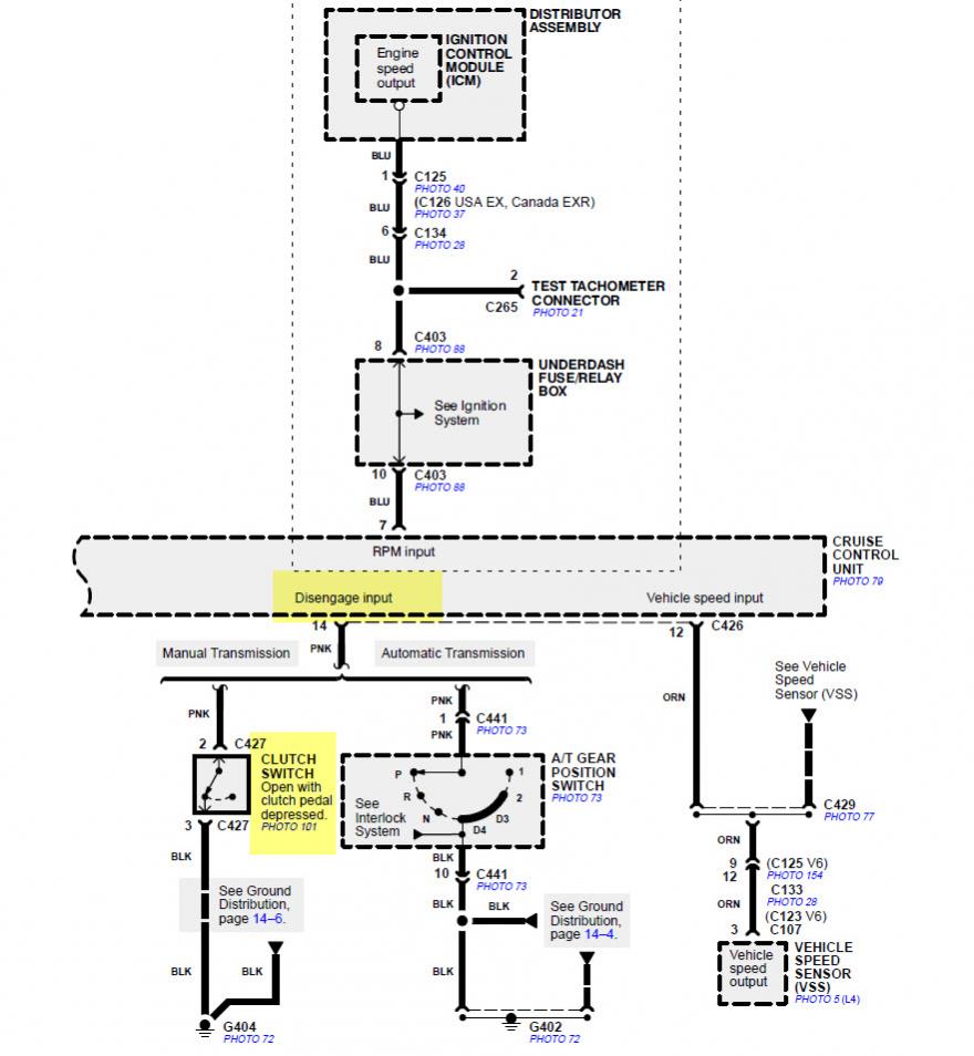

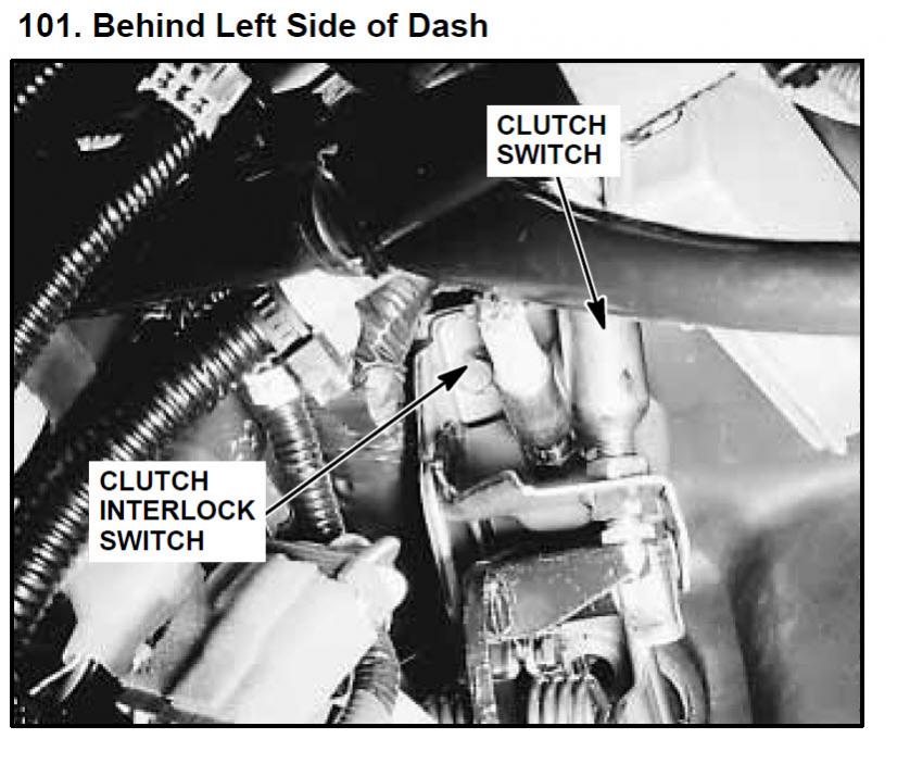

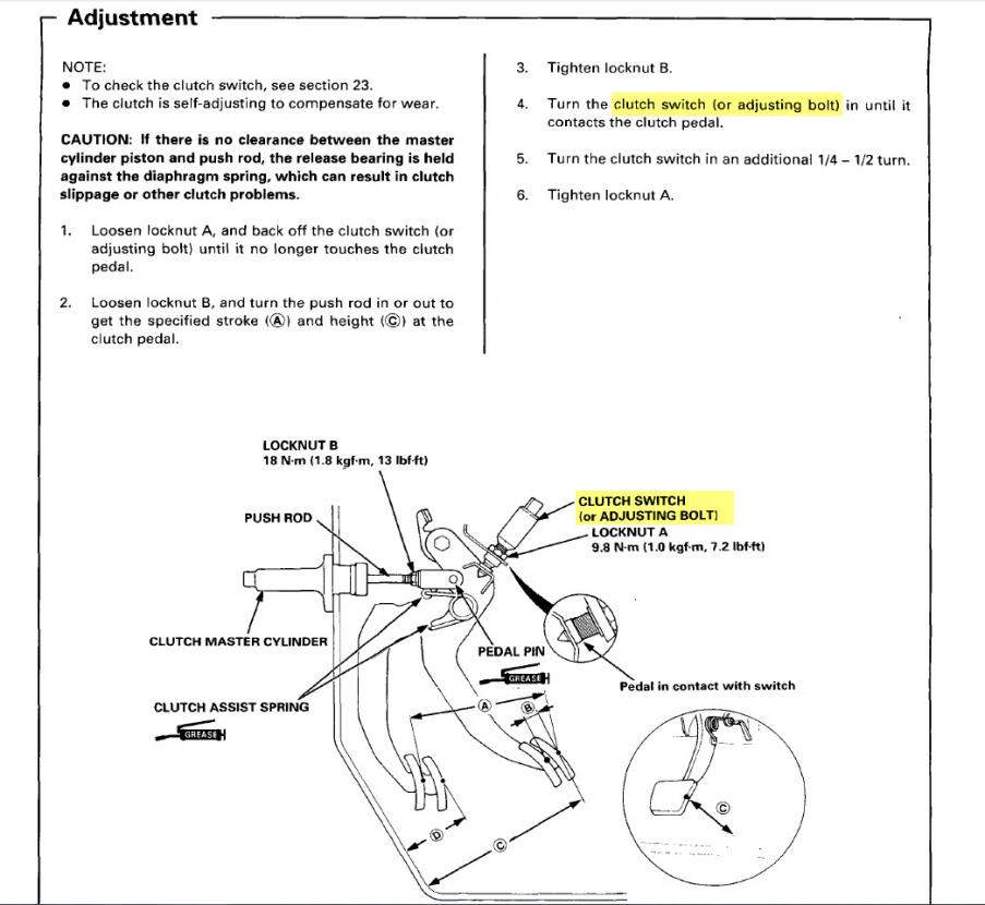

Ah, I have to say this isn't correct. In a 5th gen Accord with a manual trans there are TWO switches on the clutch pedal.
Whether there is one or two switches may depend on whether the car has cruise control or not.
1. The clutch interlock switch prevents the car from starting if the clutch pedal is not depressed. (The clutch interlock switch is not integrated into the cruise control circuit.)
2. The clutch switch is used to disengage the cruise control.

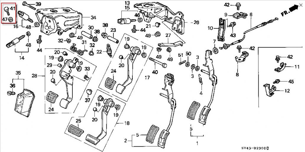

It may be that an adjusting bolt is used in place if there is no cruise control. There is another parts diagram show the clutch adjusting bolt for DX trim level.
