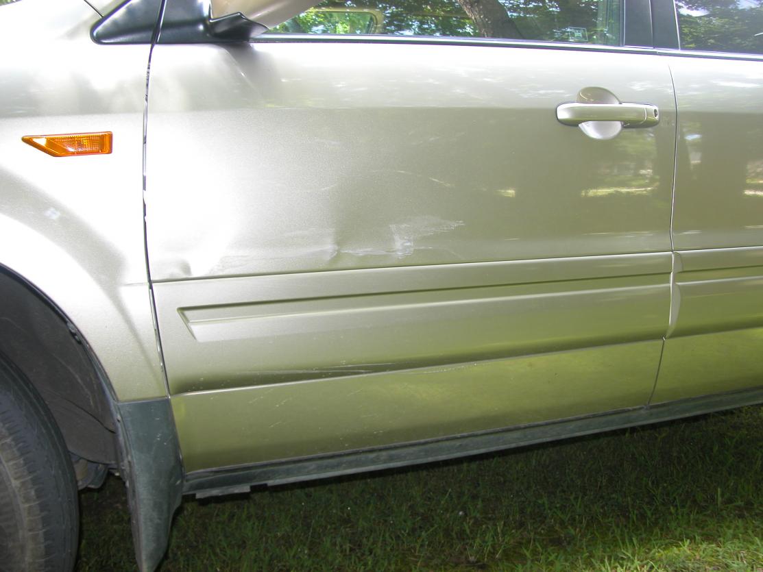

Slow down a bit....this is a forum and people have to take care of "their" issues....my wife just got home from going to the store and someone hit her Pilot in the parking lot and left........I now have a damaged drivers door, just "F" great. Post to come in the "off topic" section soon.

Edit: You did not ever "bother me" - again sorry. The wife's car issue "put me off".....there goes 1K in body work, I can't do that kind of work.....give me a timing belt and I'm fine but body work and I have nothing.
