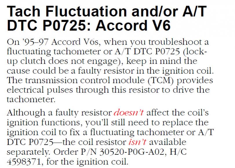

Old Nov 5, 2012 | 08:53 PM
Posts: 7,101
Also see attached.
