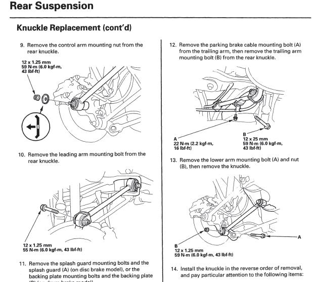

Old Nov 5, 2012 | 06:44 PM
A bigger hammer and some spray lube.
I assuming rear here.
Work the arm at the hub in and out while using the lube.
Attached Thumbnails removing a few bolts or thing off suspension-6th-gen-rear-knuckle.jpg
