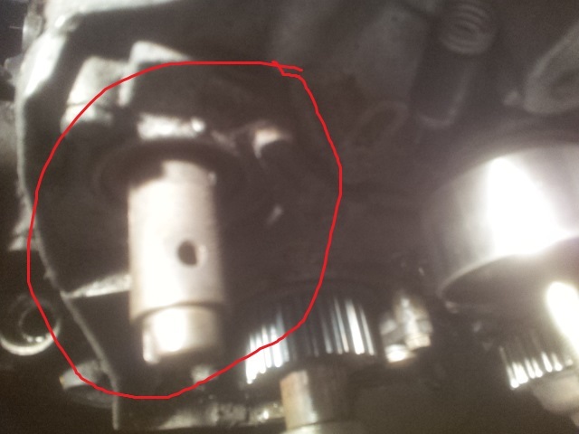

1) When I was pulling the timing off, I didn't have a balance belt or front balance pulley. When I look at the plastic timing cover it looks like the front balance pulley could have potentially shot out of the vehicle through the cover with the belt. Or it was someone's crazy hack job. Anyways, how bad is this? This car has had bad shifting since we bought it. Like really rough forward backward movement. Even after a tranny swap.
Not so crazy. Performance tuners take off the balance shafts belt to eke out a few more horsepower. I think the only downside is more engine vibration.

Anyways, never got around to checking the compression. It would have been a good idea, but sometimes I act before thinking and it gets the best of me. How big of a horsepower gain from removing the balance belt?

Also, am I able to buy a new pulley for the balance shaft? Have yet to locate one on the internet anywhere.

Well if you are not able to find something from a local junk yard. I have a couple sets of balance shaft drive gears available. I'd be willing to let one of them go for a few bucks.
PM me if you are interested!
