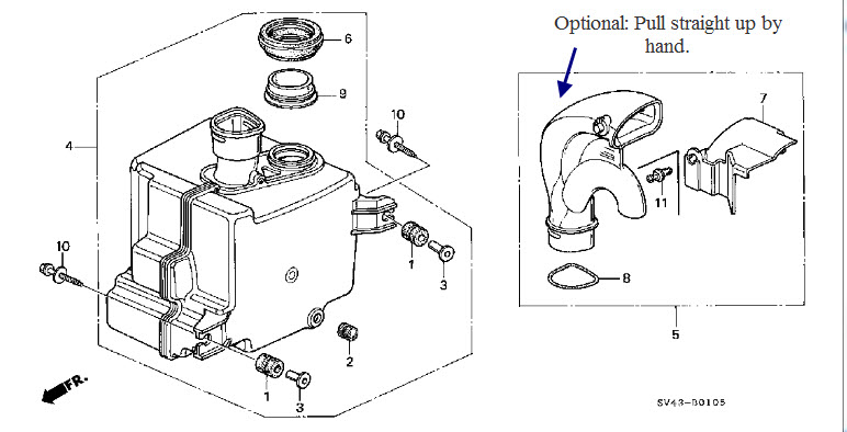

1. (Optional step, if you want a little more wiggle room.) You can remove the intake tube if you like by just pulling straight up with your hand, no tools needed. The parts diagram shows it in broken down into parts, you do not need to unscrew the screw, etc. Just pull the whole tube straight up.
2. After you loosen the bolts, lift the air cleaner housing cover up.
3. Replace air filter and re-align the upper housing cover with the lower housing cover where the bolts go back in.
4. Tighten the bolts. Do not over-tighten; otherwise, the threads may get stripped.
5. If you removed the intake tube in step #1, just align it with the resonator chamber hole and push it back down.
Attached Thumbnails 96 Accord LX....Air filter Issue-air-intake-tube-b.jpg   96 Accord LX....Air filter Issue-air-cleaner.jpg

once you remove the 4 phillip screws from the cover it comes right up, .. you might have to wiggle the cover a bit ,, on the above picture ( first 1 .. where the arrow points to it it says optional ),, you removed it correct?? just pull it straight up ,,

Thanks for the insight, I pulled it st8 up and it came off I was then able to get the cover in the right position and got all the screws back in and yes it was the right filter =)
