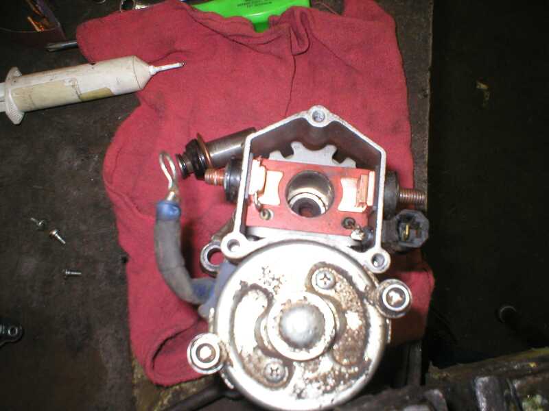

hondadude's Avatar
Joined: Aug 2006
Posts: 2,170
From: Fayetteville, AR
Starter contacts are cheap and easy to replace
