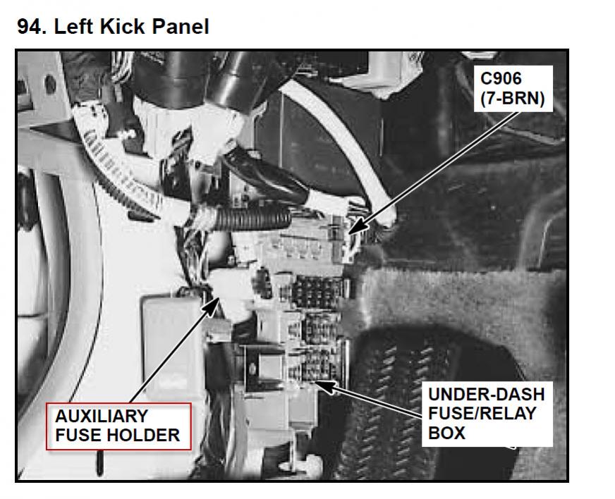

1. Which under-dash fuse did you check? Was it Fuse No. 12 (7.5A) in the Auxiliary Fuse Holder?
2. Check or re-check fuse no. 12.

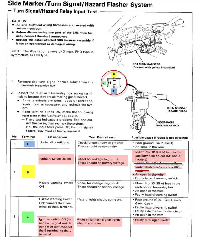

3. You can also do some tests as shown in the service manual at the socket terminals for the relay.
Attached Thumbnails 96 with No Signal Lights-auxiliary-fuse-holder.jpg   96 with No Signal Lights-turn-signal-hazard-tests.jpg

Yes Fuse 12 7.5 was checked with an Ohmeter and is good. And like I said I bought a flasher on a whim hoping it was that simple,it wasn't. Is that a factory service manual that you are using Red? If so are there any other TS instructions that I can try? I have a Chiltons manual and it's not very helpful when it's something very challenging..... Ok so if I follow step 3# this should tell me if the issue is in the the multiplexer switch. Roger I'll give it a shot I suspect this might just be the answer to this problem.....

That is from the Honda service manual.
Have you tested for voltage at socket terminal B with the ignition turned ON (II)?
Have you jumped socket terminal B to terminal L, with the ignition turned ON (II) and the turn signal switched to left or right?
I would have to look at the circuit diagram to write up any additional tests that are not in the service manual.
