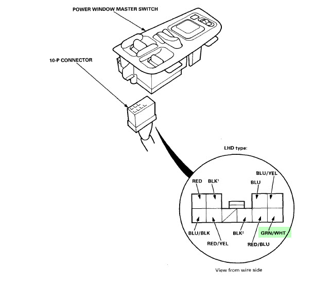

For the windows:
At the power window master switch, with the ignition turned ON; with the black lead of the voltmeter touching the metal body/chassis, touch the red lead of the voltmeter to the terminal for the Grn/Wht wire at the harness plug (see pic.) to see if you have voltage coming in.
Attached Thumbnails 97 accord 2.2 non vtec - Radiator Fan, Powered Window and Sunroof Problem-power-window-master-switch.jpg

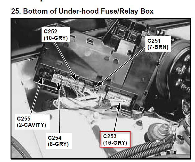

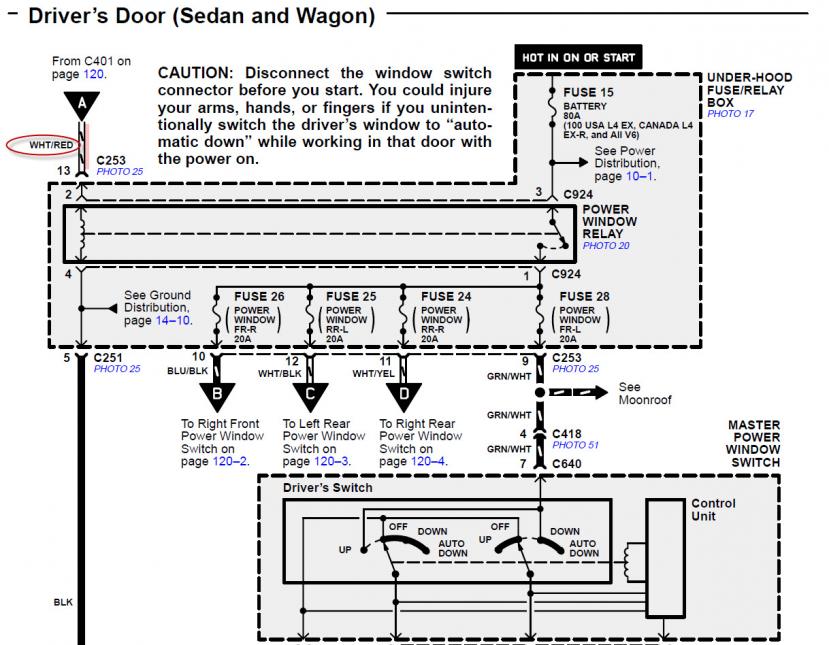

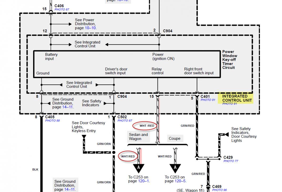

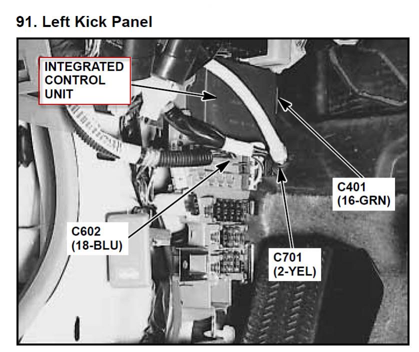

From your description where you have to jump a wire from the battery to where the power window relay is, it sounds like power via the Wht/Red wire from the Integrated Control Unit (located in the driver's under-dash fuse/relay box is not going to the power window relay in the under-hood fuse/relay box. The Wht/Red wire connected from the integrated control unit goes through connector C253 at the back of the under-hood fuse/relay box to the power window relay.
The way the power window circuit works is when the ignition switch is ON (II) (and for 10 minutes after it is switched to LOCK (0) and as long as both front doors remain closed), the integrated control unit provides voltage to the coil of the power window relay. The contacts of the power window relay close and voltage is applied to the master power window switch and all the window switches in the doors.
You stated you checked fuses and all lights work, etc.; so, it may be a problem with either the integrated control unit, the wiring, or the connection.
Attached Thumbnails 97 accord 2.2 non vtec - Radiator Fan, Powered Window and Sunroof Problem-integrated-control-unit.jpg   97 accord 2.2 non vtec - Radiator Fan, Powered Window and Sunroof Problem-icu-circuit-power-window-relay.jpg   97 accord 2.2 non vtec - Radiator Fan, Powered Window and Sunroof Problem-wht-red-wire-icu-power-window-relay.jpg   97 accord 2.2 non vtec - Radiator Fan, Powered Window and Sunroof Problem-c253-connector-bottom-underhood-fuse-box.jpg
