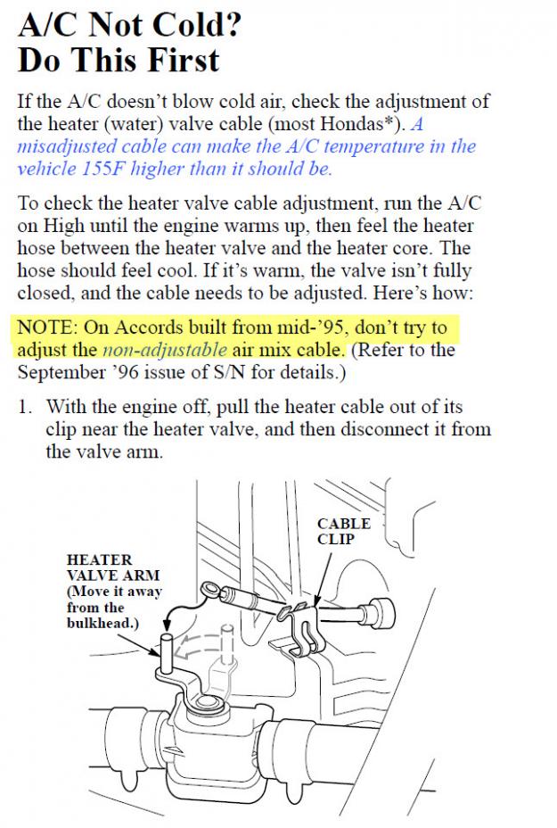

Check the heater valve first, it may be a misadjusted heater valve cable, a stripped valve or both. Disconnect the heater valve cable and check the heater valve arm for looseness. If the stem screw is loose or the arm has any play, you found a likely cause for the problem. A heater valve in this conditions is usually considered irreparable, so replacement would be necessary.
See this for adjustment of heater valve cable:
https://www.hondaaccordforum.com/for...adjustment-jpg
https://www.hondaaccordforum.com/for...c-not-cold-jpg
