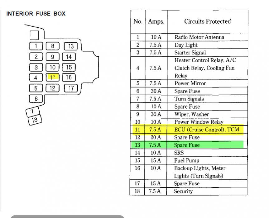

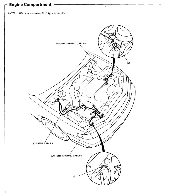

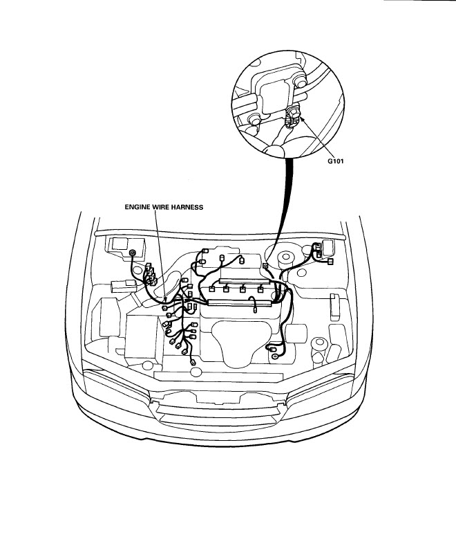

In the attached pics:
  • Check these engine grounds to see that they are tight and wiring okay. You may even want to remove them and clean the surfaces with some sandpaper, etc.
  • For the under hood fuses, check the main battery fuse, other highlighted fuse, etc.
  • For the interior fuse, check the yellow highlighted fuse. The fuse box should have spare fuses as indicated (the green highlighted fuse is a spare 7.5A fuse) you can use. You can also check the starter fuse (not highlighted).

Thanks for the quick response, and sorry about my delayed reply. I went ahead and double checked the connections and everything and it started up. There was a little corrosion on the battery that was probably not helping the problem either!
Thanks for your help!
