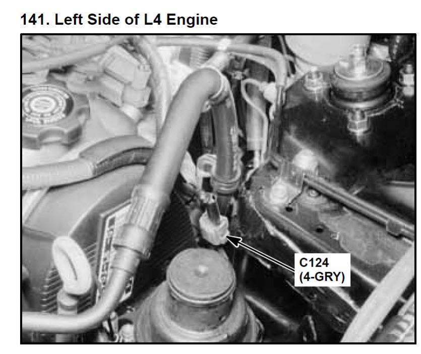

Old Dec 16, 2014 | 01:39 PM
This attached photo is for the harness connector for the TDC/CKP sensors. This connector is part of the main engine harness. Follow along the main wire harness to look for the separate harness wiring that should have been connected to G101.

Found missing wire, it was folded behind another one Thanks for the Help
