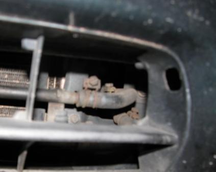

Old Oct 26, 2011 | 08:33 PM
They come in handy Should have seen them in action doing the PS pressure hose on the 89 LX
Now, the lower grill openings on the 97 might be different but I'm 99% confident I could do this on my 95 thru the lower grill
Attached Thumbnails 97 Accord Wagon Return Power Steering Hose-5th-gen-ps-cooler.jpg

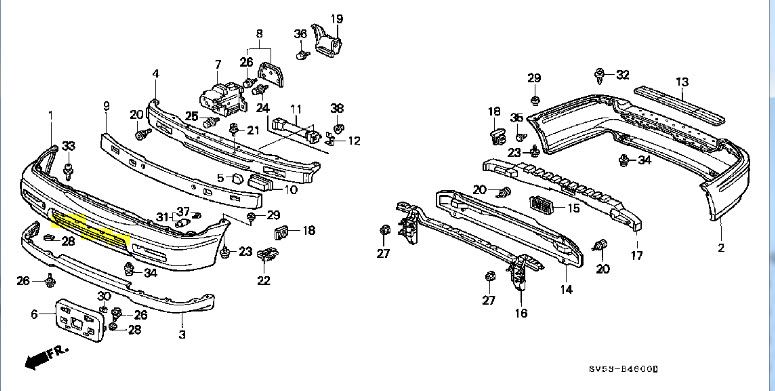

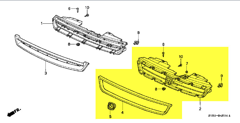

Old Oct 28, 2011 | 09:40 AM
Posts: 7,101
TexasHonda is referring to the grille and I believe you're possibly referring to the air flow opening in the bumper.
Attached Thumbnails 97 Accord Wagon Return Power Steering Hose-grille.jpg   97 Accord Wagon Return Power Steering Hose-bumper.jpg
