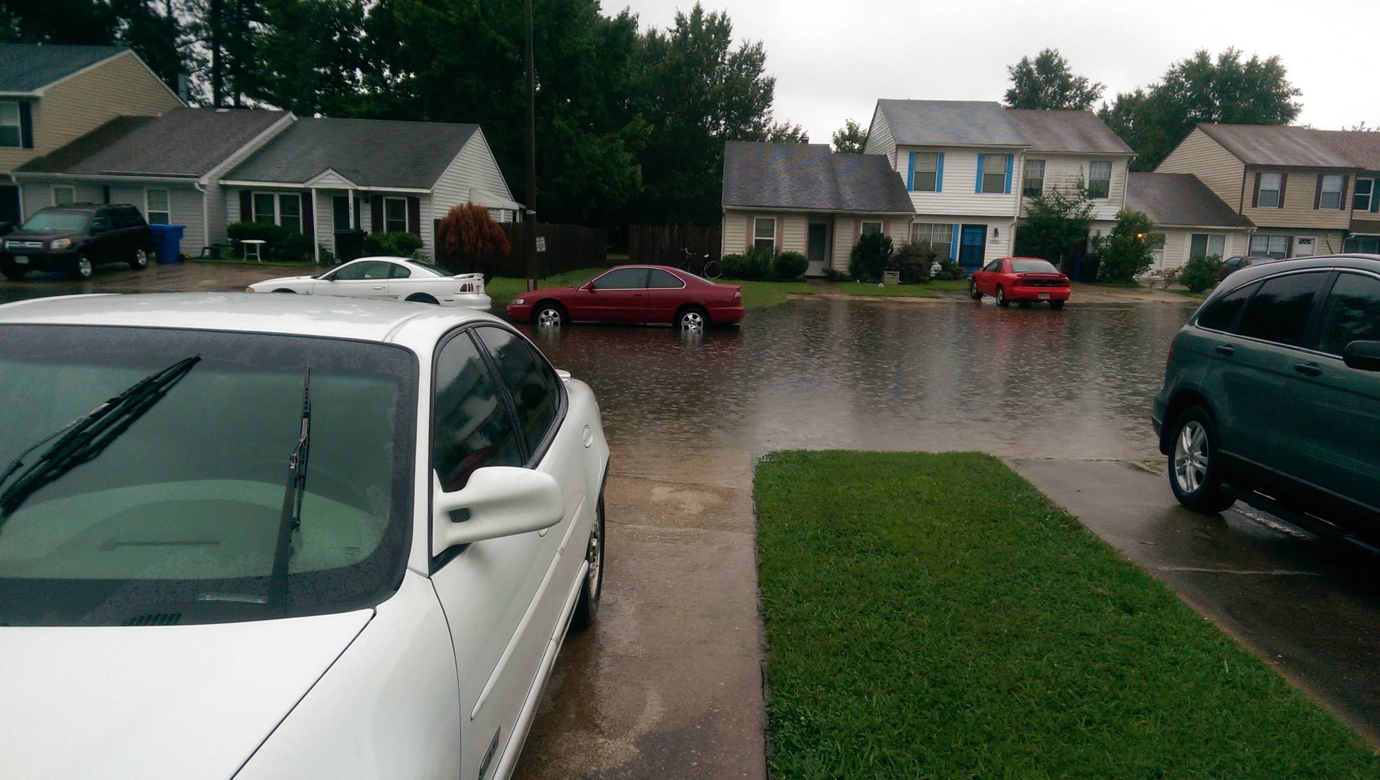

So a massive flood came through very quickly in my neighborhood and my 97 sat in it for a little while, as shown below. The water was a bit higher than this when we went to go push it out, but it never touched the bottom black molding of the exterior/door.
