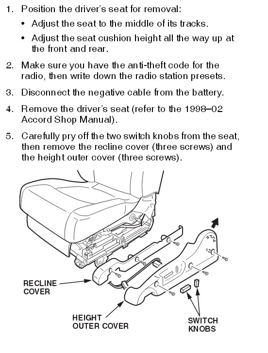

Sounds like you have the 8-way powered seats. 2-way only goes up and down.
You may have to remove the driver's seat first to see what the problem is. It is a problem with or at the recline adjuster; but, check that the bolts are not broken or damaged at the recline adjuster or if there may be something you can do to make it work properly again.
To remove the seat to examine the recline adjuster and bolts:
1. Position the driver’s seat for removal:
• Adjust the seat to the middle of its tracks.
• Adjust the seat cushion height all the way up at the front and rear.
2. Make sure you have the anti-theft code for the radio, then write down the radio station presets.
3. Disconnect the negative cable from the battery.
4. Remove the driver’s seat. There are four bolts that hold down the seat tracks. Pry the plastic covers off the seat track ends, then remove the 4 bolts. Then lift up the seat and disconnect the electrical seat harness connector.
5. Carefully pry off the two switch ***** from the seat,then remove the recline cover (three screws) and the height outer cover (three screws). (See attached pic. for cover removal.)

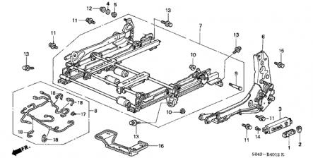

The recline adjuster part varies depending on your specific model; but, it is like part #6 in this diagram. If it needs replacement, it is not cheap new; so, salvage yard may be a good option.

most likely you got an issue with # 6 ,make sure that the bolts are all in and are tight
