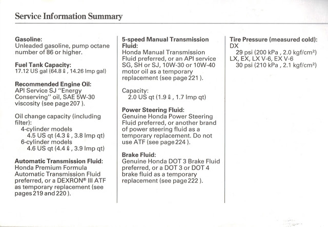

FWIW for my car 5qt is just slightly over the upper mark.
Attached Thumbnails '99 Accord 4cyl. holds 5 qts. of oil?-02-10-2013%25252009%25253b24%25253b27am.jpg
