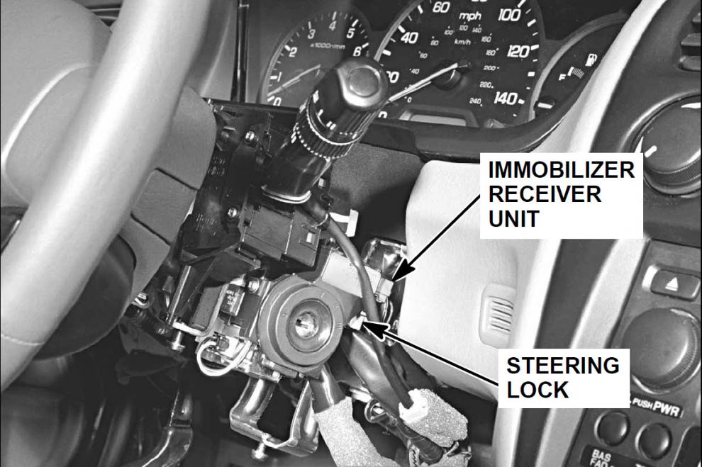

Testing wiring at the Immobilizer Receiver Unit (located on steering column).
Backprobing may be more effective in the following tests. Backprobing is either using a backprobe set or using a thin needle or something and making contact with the metal terminal of the connector without piercing the wire in the back of the still connected connector. Care must be taken to ensure that the wiring does not get damaged. You can use something like a T pin, available at Walmart, etc., and backprobe. These pictures are just to give a picture of the concept of backprobing without piercing any wires.
https://www.hondaaccordforum.com/for...%5D-t-pins-jpg
https://www.hondaaccordforum.com/for...back-probe-jpg
(Test for ground source from Ground G101 through wire) - At the 5-pin connector to the receiver unit, test for continuity to body ground at terminal no. 4 (where the Brn/Blk wire is).
To test for continuity, set to either the "ohms" or the setting it will beep when you hold the two leads together.
  • If your meter beeps, it means you have continuity.
  • If it is on ohms scale, you will have continuity when it reads close to 0 ohms.
  • If it doesn't beep , shows OL (open line) or a 1 (infinity ohms); it means you don't have continuity.
Don’t turn on ignition for this continuity test. You can either unplug the 5-pin connector and test the Brn/Blk wire or backprobe. There should be continuity to ground.
(Tests for signals between immobilizer receiver unit and ECM/PCM):
1. At the 5-pin connector to the receiver unit, backprobe terminal no. 1 (where the Yel/Blk wire is). Set the multimeter for voltage test.
With a voltmeter, touch the voltmeter's red lead to the Yel/Blk wire and the voltmeter's black lead to body ground (for example, a metal bracket on the car, etc.) to test.
With the ignition in ON or START, is there power at the Yel/Blk wire?
2. If there is power at the Yel/Blk wire, then backprobe terminal no. 3 (where the blue wire is).
With a voltmeter, touch the voltmeter's red lead to the Blu wire and the voltmeter's black lead to body ground to test.
With the ignition in ON or START, is there power at the Blue wire?
3. If there is power at the Blue wire, then backprobe terminal no. 2 (where the red wire is).
I am not sure whether the encoded signal from the receiver unit’s red wire will be power (+) or ground (-) when trying to start the car.
With a voltmeter, touch the voltmeter's red lead to the red wire and the voltmeter's black lead to body ground to test.
Either way, with the ignition in ON or START, is there a reading at the Red wire using the voltmeter?
Attached Thumbnails 99 accord  would not start.-immobilizer-receiver-unit.jpg
