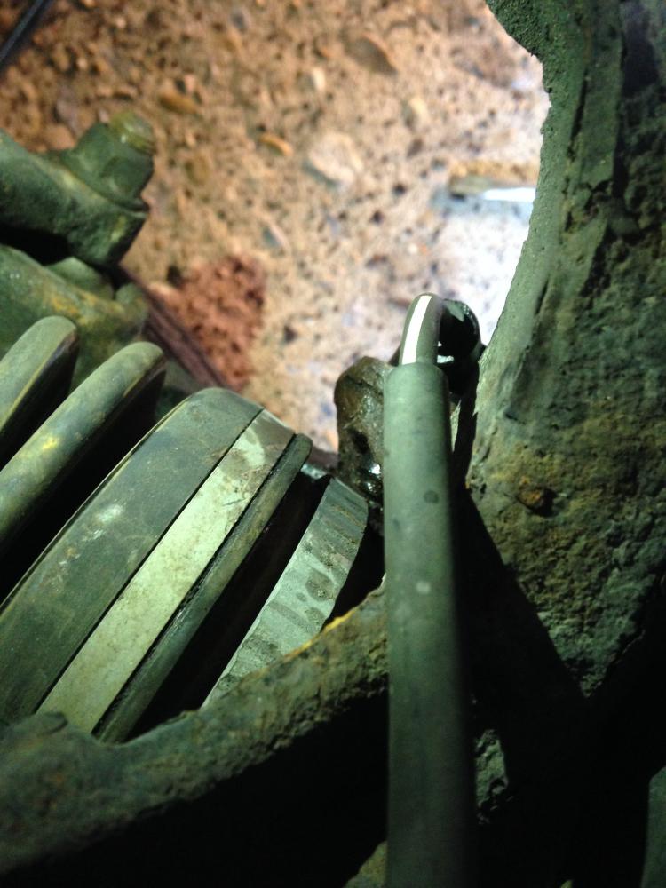

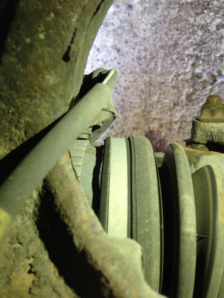

Right now I have the car jacked up and I think the tone ring is misaligned on the driver side front wheel. Pictures for reference:
Good side (right): '99 EX V6: ABS odd behavior after tranny rebuild-2014-03-09-16.37.42.jpg
Bad side (left): '99 EX V6: ABS odd behavior after tranny rebuild-2014-03-09-16.36.42.jpg
It looks like the tone ring is off alignment on the left side. Any suggestions to fix this? Or should I just take it back to the transmission shop and tell them to fix it?

See what the shop says, first. It sure does look like the left side isn't lined up.
Photo of the right side: See how the sensor is straight, square, & close to the tone ring?
Possible bent bracket on the left side? I don't remember what that looked like besides I didn't have a V6.
What about the outer CV joint not being completely seated properly? If that's the case, it has consequences for your wheel bearing.
