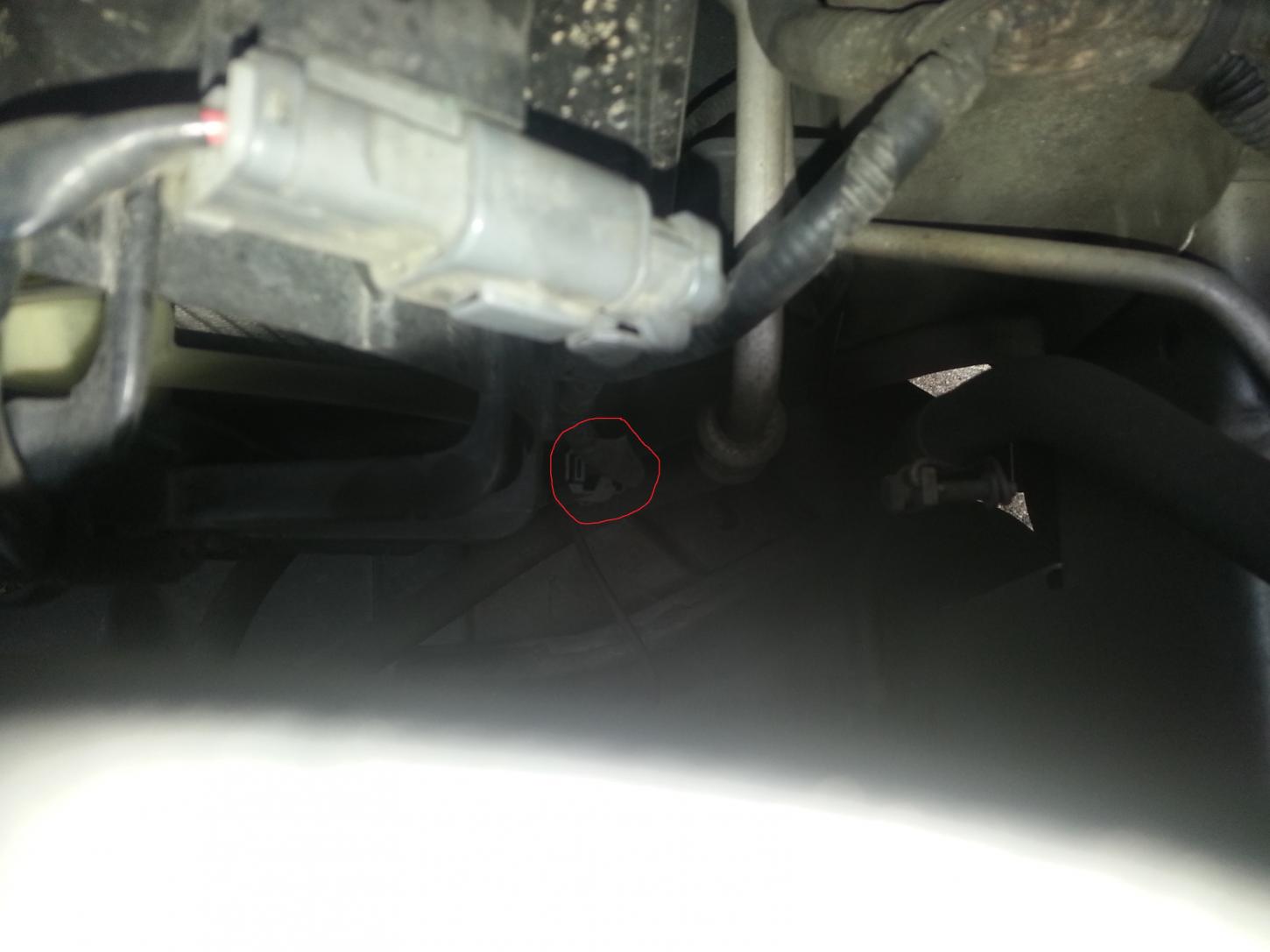

Unfortunately, I don't know how to check for a closed circuit either. I'm going to include a picture I took of what I think is the pressure switch electrical connector - circled in red. Not sure how I would jump it.

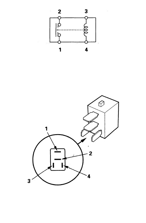

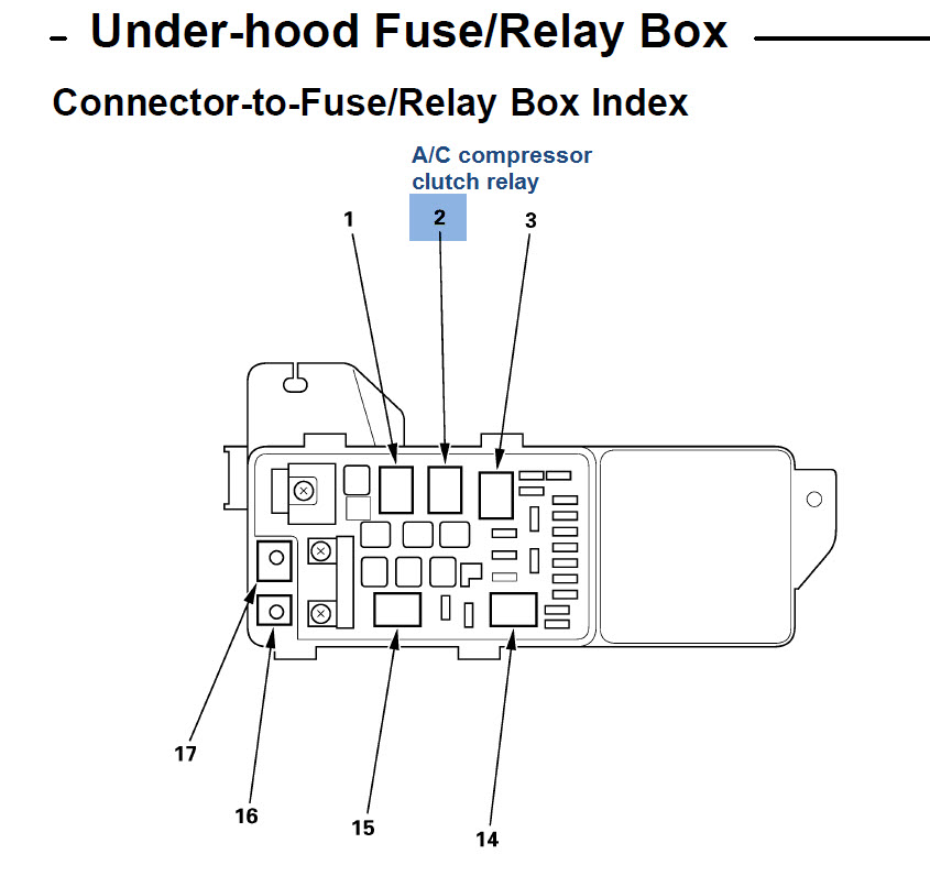

1. The A/C compressor clutch relay is number 2, as shown in the attached under-hood fuse/relay box diagram.
2. You would pull that relay out, then use a jumper wire where relay terminals no. 1 and no. 2 would normally be plugged into.
Warning: It is not a fix, in any measure. This is only a test. Do not leave it like that.
Attached Thumbnails Accord 03 EX Navi - air conditioning stopped working-ac-compressor-clutch-relay.jpg   Accord 03 EX Navi - air conditioning stopped working-relay.jpg

1. Your picture with the electrical connector circled in red is the connector for the A/C compressor, which supplies power via the A/C compressor clutch relay located in the under-hood fuse box. That is not the A/C pressure switch.
2. The A/C pressure switch is attached to piping connected to the A/C condenser.
