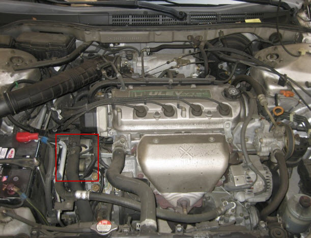

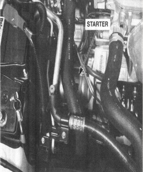

Old Jun 25, 2012 | 11:59 AM
Originally Posted by dmalay1
Thanks. I am not much of a DIYer, but I can try the first part. Where is the starter located?
You posted right before my last reply.
The starter is located as shown on in the attached pictures. A little bit hard to reach though.
Attached Thumbnails Accord does not start-starter-location.jpg   Accord does not start-starter-location-2.jpg
