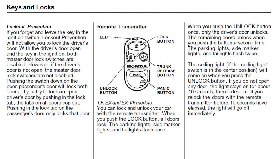

The driver side automatic locks do not have any effect on the driver's door or the back right door. I am fairly certain that the passenger side auto locks don't work on these doors either. Any suggestions?
3. Based on owner's manual front doors master lock should lock and unlock all doors. See attached pics for owner's manual excerpts.

Attached Thumbnails Advice For a Few Issues with My 1999 Accord-power-door-locks.jpg   Advice For a Few Issues with My 1999 Accord-power-door-locks2.jpg
