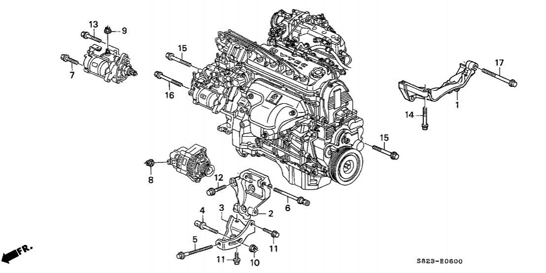

I have a Honda Accord Automatic Hatchback.However the Mechanic who fitted my new alternator seemingly has not done the job properly,the alternator belt keeps slipping,and the nut which holds the belt is not sufficient to keep the hold on. I cant find a mobile mechanic in my area nor garage which do callouts. So literally stuck.I can see it looks a simple job,but know zero about cars,any help or pointers woul be gratefully received.The battery and alternator are fine.

It is an Accord 1.8i year 2000.the belt seems fine looks new,but the nut holding the belt keeps loosening.

What comes loose exactly? You have to tighten #6 & #10 as well. The #5 bolt is just to pull the alternator out for tensioning.
