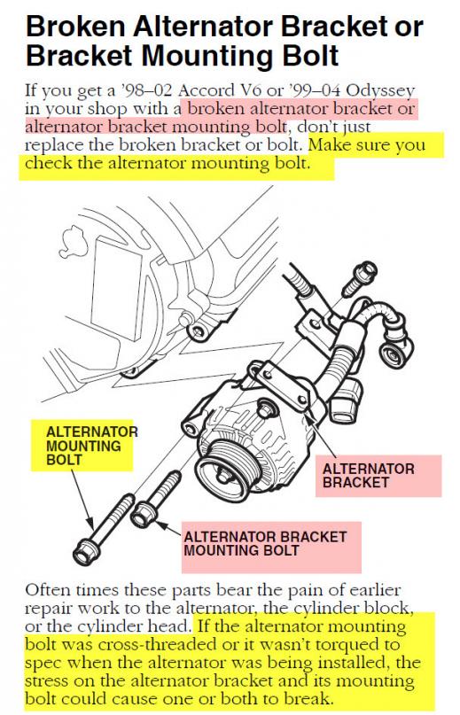

The info. is in another thread I responded to before.
If the alternator mounting bolt is cross-threaded or wasn't torqued to spec when the alternator was installed, the stress on the alternator bracket and its mounting bolt can cause one or both to break.
See attached pic. for the info. Note that I highlighted in yellow which mounting bolt to check and possibly replace too.

Thanks red bull. I asked my mechanic to check the alternator mounting bolt. He said it was ok. Is it just better to replace that bolt?
Old Jan 18, 2013 | 02:21 PM
To be on the safe side, I would recommend replacing the bolt and then properly torque it.
