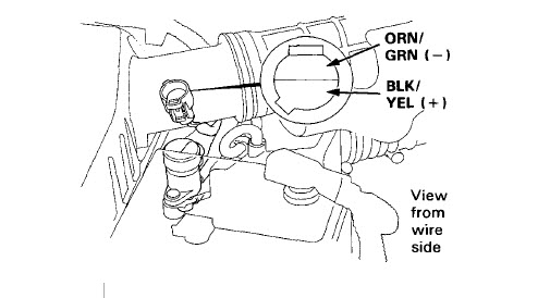

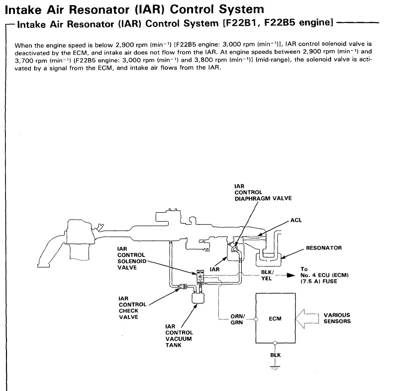

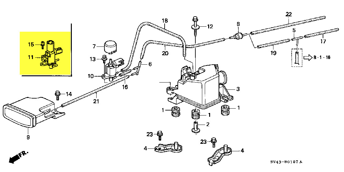

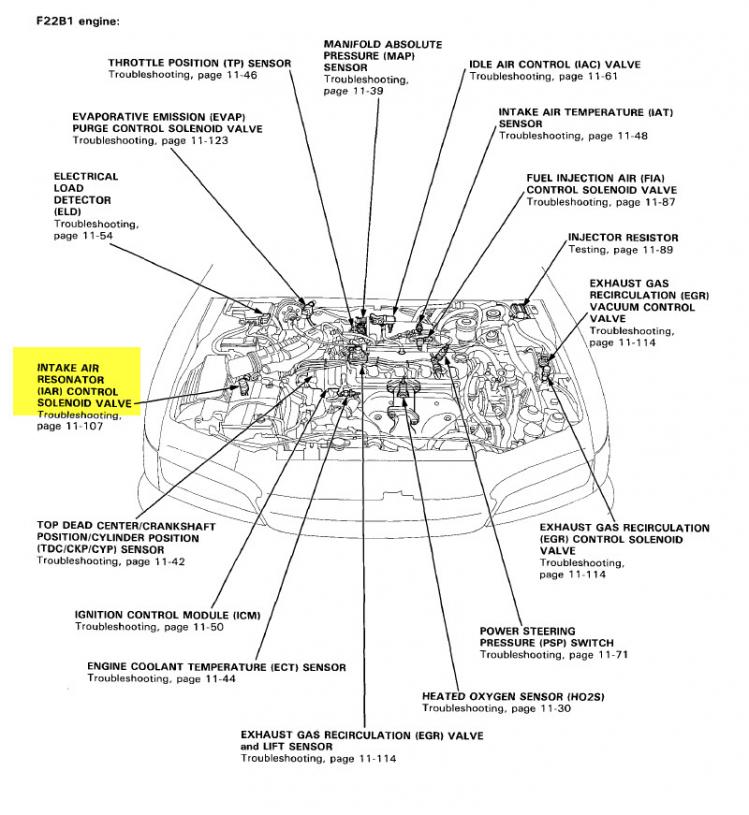

Intake Air Resonator (IAR) Control Solenoid Valve, which was previously mounted on Resonator Chamber B (Part # 3 in first picture, which was probably removed).
See attached pics.
