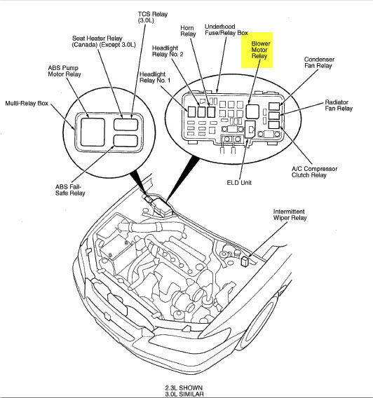

It may have been a shorted blower motor relay which was draining your battery. Has that or whatever was causing the electrical drain been replaced/fixed?
Attached Thumbnails Battery dying after sitting overnight-blower-motor-relay.jpg
