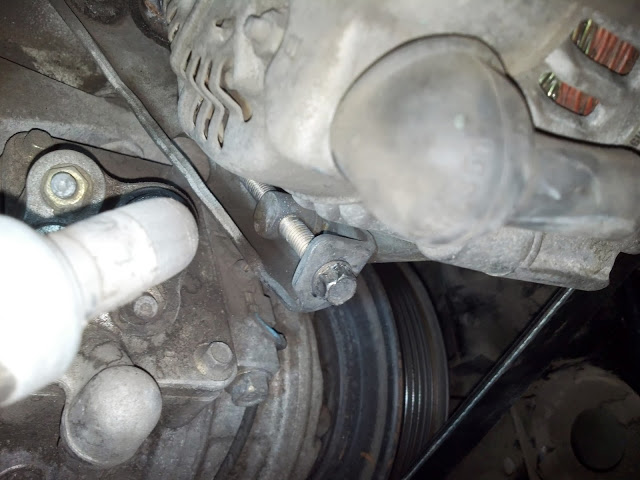

I finally had a chance to get in there so I found and loosened the 12mm and 14mm bolts, and I think I found the 10mm one, but it's functioning like any other bolt on the car: it's already pretty tight and only gets more so when I tighten it. I've only turned it a half turn and it's gotten to the point where I'm afraid I'll either strip it or break it (and now it's squealing even louder and 100% of the time). From the look of it, I would expect I should be able to loosen or tighten as much as I want, as one would expect from a tensioning bolt, but the bolt I'm working on isn't working that way. I've attached a shot of the bolt I think you're referring to. Is this the right one? (Sorry for the odd angle: not a lot of room in there).

Yes that is the adjustment bolt for the alt. Be sure the mounting and lock nuts/bolts are loose enough.

And try loosening the adjusting bolt. If it loosens, back it out quite a ways and put some anti-seize or a drop of oil on the threads. You should be able to move the alternator up and down by hand when that bolt is backed out.

Thanks for all of your input and sorry for the lagging responses, but I'm working crazy hours lately and haven't been able to get under my hood again until today. I had the same thought as Roader and tried that, but with no difference in squealing. I was also curious, and found I was right, that I am able to adjust the 10mm bolt without loosening the 12mm and 14mm bolts... I've loosened it quite a bit in the other direction and tightened it as tight as I can but it all squeals just as much on startup. Not sure where to go from here...

Something's wrong. Maybe the 6mm adjusting bolt is stripped or the 6mm adjusting nut/threaded bracket (I forget which) is stripped or both. With the two through bolts loose and the adjusting bolt backed off the alternator should move up and down through its adjusting range. Does it?
Edit: By 6mm I'm talking about bolt diameter, not the size of the bolt head. The adjusting bolt head size is 10mm, just as the through bolts have 12mm and 14mm heads.

I actually did try to move the alternator up and down per your suggestion once the 12mm and 14mm bolts were loose, but it wouldn't move at all. I also tried completely removing the lower bolt and backing the swing bolt way out but still the alternator wouldn't budge. It seems a little strange being that I just had it in the shop for this in January, but I suppose over 5 months things can get tight??? None of the bolts appear to be stripped though, they will tighten up just fine. I sprayed a bunch of DW-40 (only thing like that I had laying around) on the adjuster bolt earlier this morning, I'll head out in a few to see if that made it to where it will tighten down further.

No location listed but it might be corroded. Aluminum on steel, dissimilar metals. If so it can usually be freed up by putting short piece of 2x4 on the alternator and banging on it with a decent weight hammer. The alternator has to pivot around the top bolt. The bottom bolt goes through a radiused slot in the bracket. The bottom bolt has to slide in that slot.
