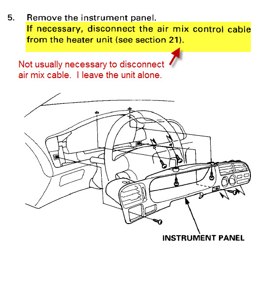

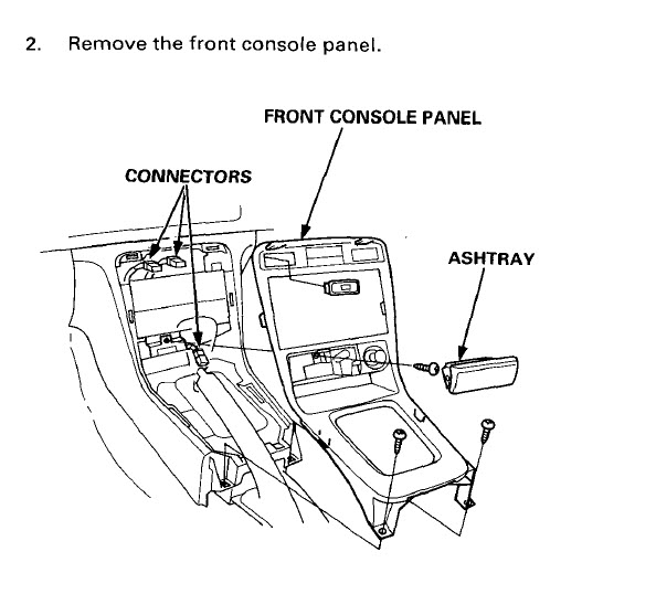

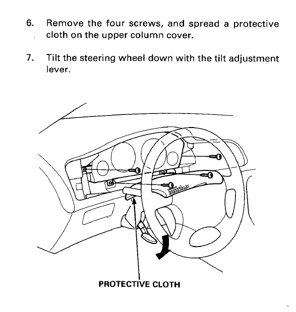

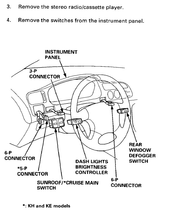

Old May 26, 2012 | 10:07 AM
Posts: 7,101
I have done it several times. The best and easiest method is from the service manual. The part to skip is regarding the climate control, I just leave the cables on the unit and leave the unit there.
See attached pics. (which will be in two separate posts)
To be continued...
Attached Thumbnails Best procedure to remove gauge cluster-step-1.jpg   Best procedure to remove gauge cluster-step-2.jpg   Best procedure to remove gauge cluster-step-3-4.jpg   Best procedure to remove gauge cluster-step-5.jpg   Best procedure to remove gauge cluster-step-6-7.jpg

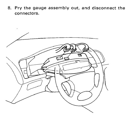

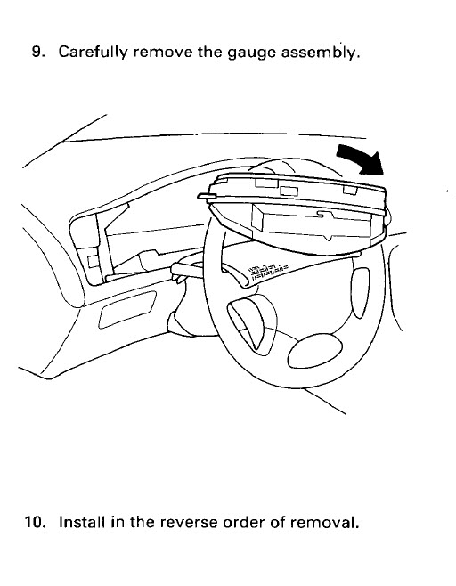

Old May 26, 2012 | 10:08 AM
Posts: 7,101
Continued and conclusion.
Attached Thumbnails Best procedure to remove gauge cluster-step-8.jpg   Best procedure to remove gauge cluster-step-9-10.jpg
