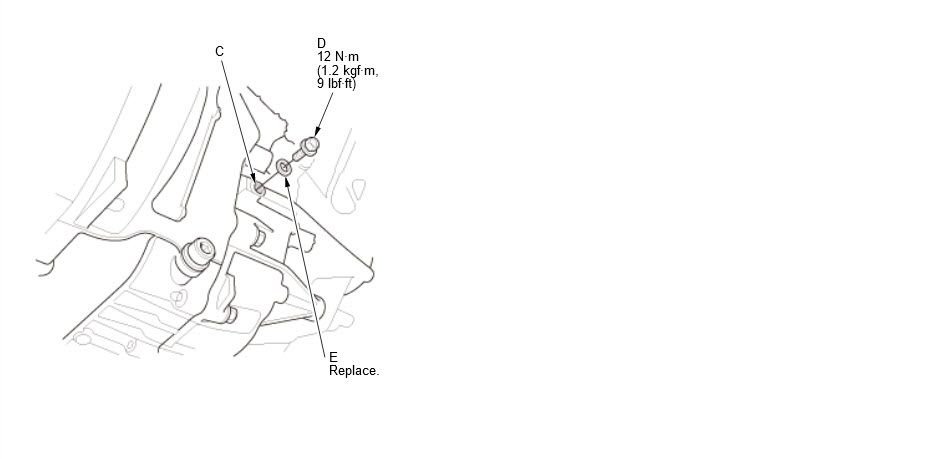

I'm learning, so I took a picture of what I believe is the transmission bolt to drain out the transmission, I circled it in red. Is this correct?
Old Apr 9, 2024 | 10:35 AM
Posts: 16,334
That is the drain bolt. You will want to find the fill bolt and remove it first, so you know you can refill the transmission before draining it.

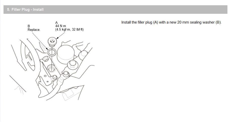

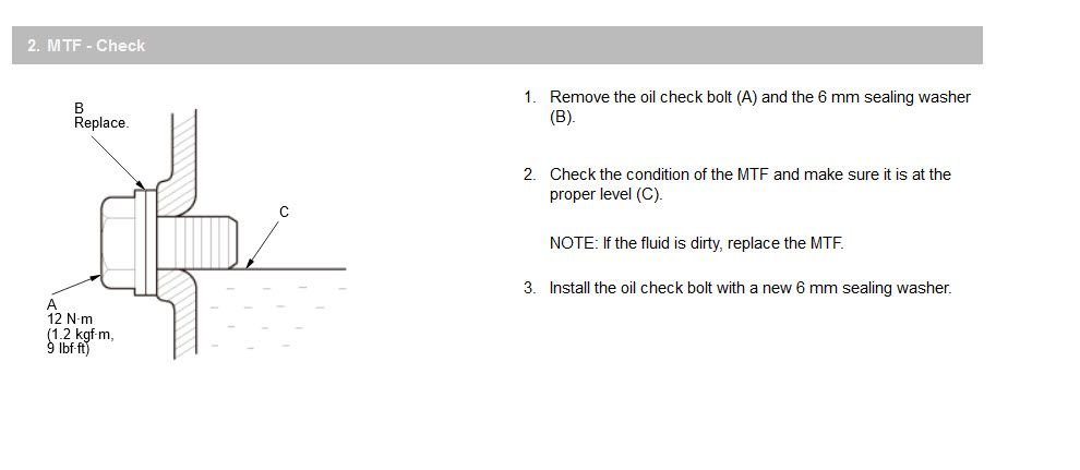

The fill bolt on the V6 is on top of the transmission. You should also locate the check bolt on the side of the transmission (further up from the drain bolt, facing the drain bolt head, to the right side).
Essentially 3 bolts for proper draining, filling, and level check.

interesting. I was looking at videos and they all show the drain bolt on the bottom side of the transmission, but you're saying it is on the top. The top side is supposed to be the fill bolt or fill plug. So, if you don't mind, are you saying to drain the transmission, this drain bolt is on the top of the transmission?
Old Apr 9, 2024 | 04:14 PM
I had a typo, I meant the fill bolt is on top.
Old Apr 9, 2024 | 04:21 PM
Here are illustrations.
