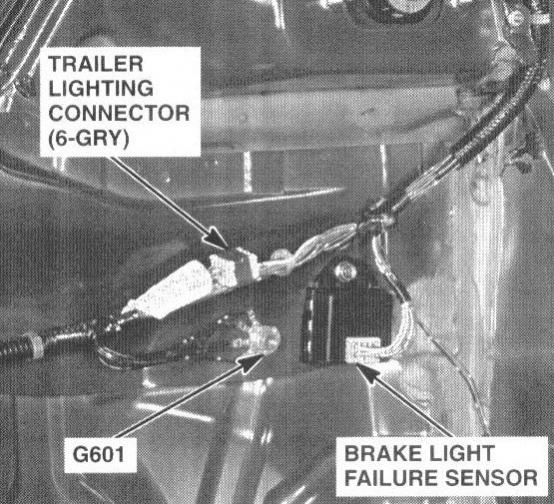

have a 2000 accord v6 ex and need to know where brake light failure mod is located...

It is a black box on (I think bolted to) the driver's side taillight.
Old Mar 19, 2013 | 07:46 AM
2-door or 4-door?? Sometimes that stuff is different.

2 door

left rear of trunk
