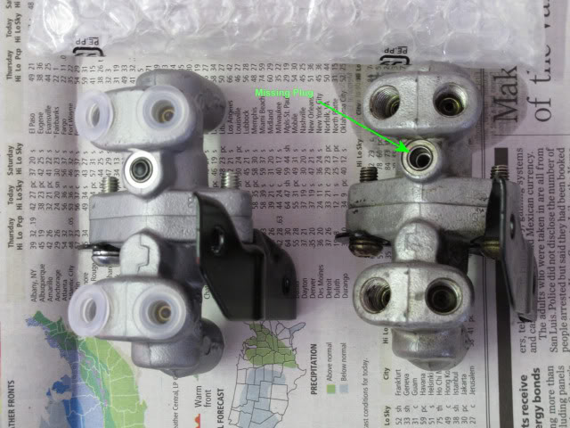

I saw a thread on Honda-Tech where a poster showed a rubber plug that he pulled out of a Proportioning Valve. Here's a picture of the one in my car after I cleaned it up a bit. I think I'll just replace it with a new one ... about $150.

Changing out the proportioning valve ... what a pain! I just got the valve out and it took me hours to do even with the master cylinder out of the way. Taking a short break before I dive back in to install the new one. The little rubber stopper in the middle is missing and I believe there's where it was leaking fluid.

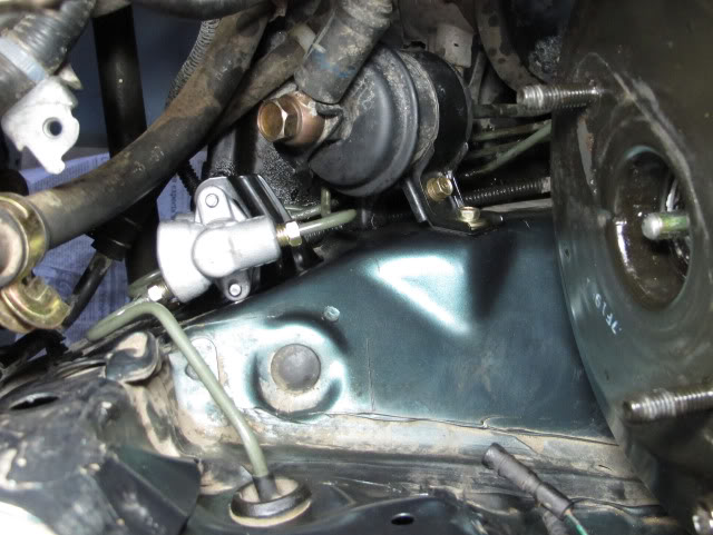

Posts: 54
From: Arizona
There just isn't that much space to swing a wrench to remove those hard-line fittings. Found out you can reach the lower front fittings from below the car too. The mounting bracket bolts were difficult to reach. After starting the one mounting bolt that you can see from above, I used a 10mm magnetic nutsetter to start the other bolt that was obscured by the bracket. The installation wasn't too bad. It was just difficult leaning into the engine bay for long periods of time cranking on those brake line fittings. But after doing it once, I think another time wouldn't be quite as bad. Assembly went much smoother. Bleeding the brakes now.

Got the new proportioning valve installed. Here's the new and old valve side-by-side. Notice the missing plug on the old one. Installed a new Master Cylinder too. Gave me a good excuse to flush the brake lines with new fluid, which was 6 years old and pretty nasty looking.
