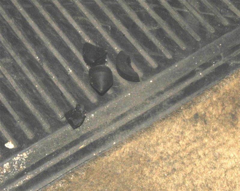

Easy thing to do is pull the fuse in the under hood fuse panel- stop or tail lights, something like that.
Look on the floor mat for strange little plastic pieces.
I'm betting the plastic stopper has given out.

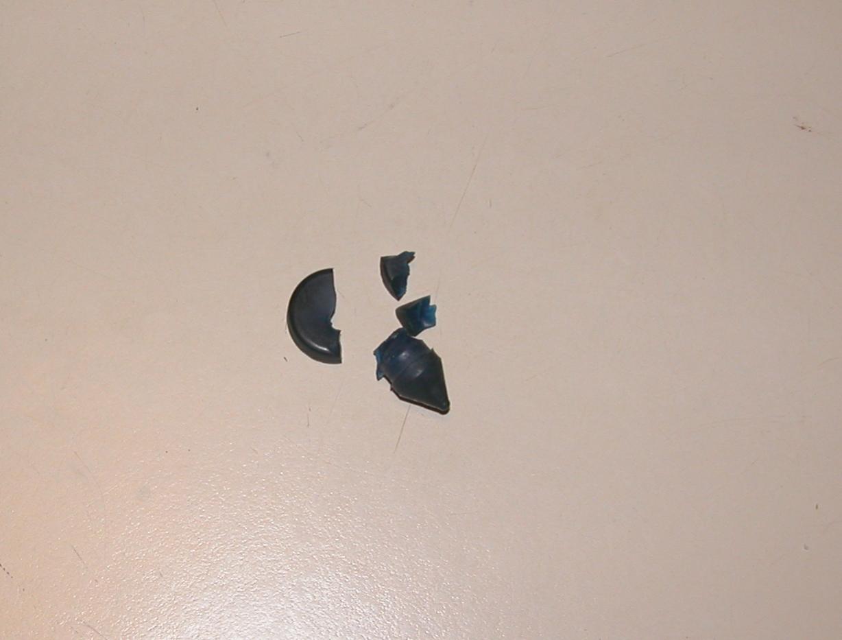

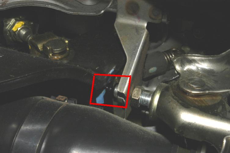

Thanks, it was the brake petal stopper. Thanks for the tip on the fuse. I removed the fuse for tonight and I'll reinstall it in the morning. I took a pic not knowing exactly where this plug goes into. My camera is bulky and by chance the battery was drained so I only got a few shots. If the pic makes since can someone circle the area where the stopper goes into. I get more shots tomorrow. I take it this part is available at the dealer as the brake petal stopper?
Thanks for your time.
Attached Thumbnails Break lights stay on-brake-0.jpg   Break lights stay on-brake-2.jpg
Old Mar 27, 2013 | 06:51 AM

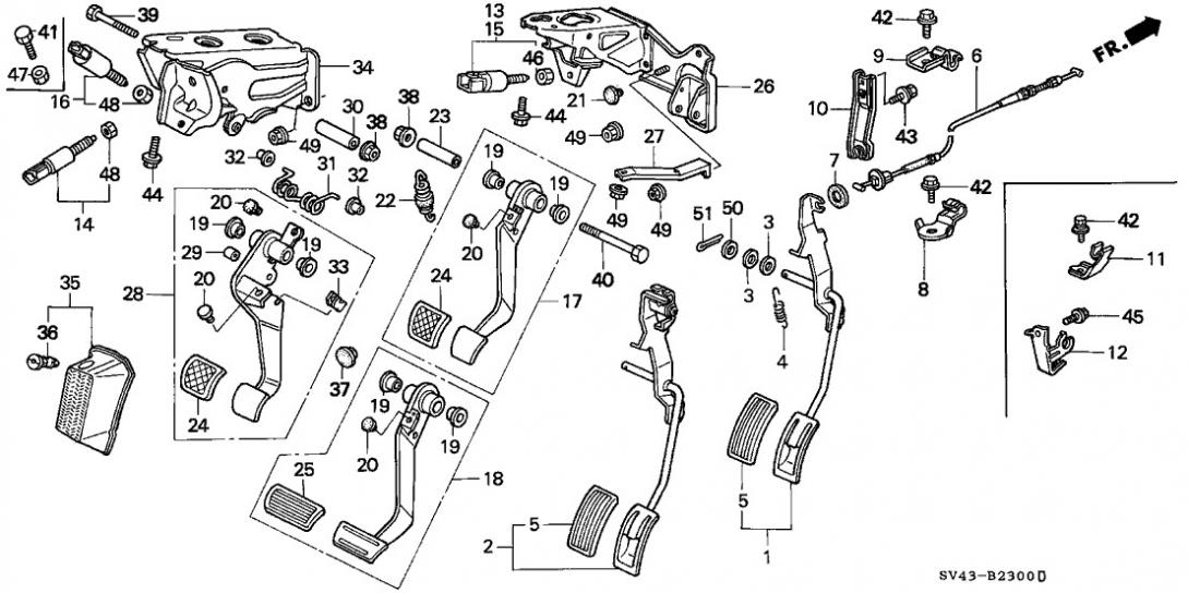

That plug is #20 near the hinge of the brake-pedal arm. It pushes against the plunger of the brake-light switch #15.
It's a couple bucks at the dealer, unless you find something temporary like a rubber cork or something.
