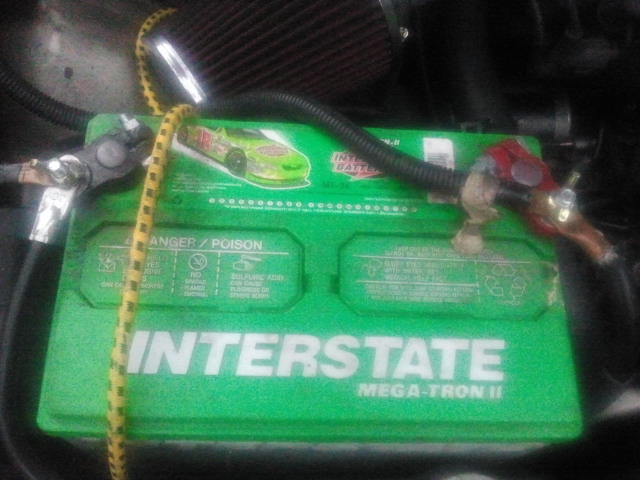

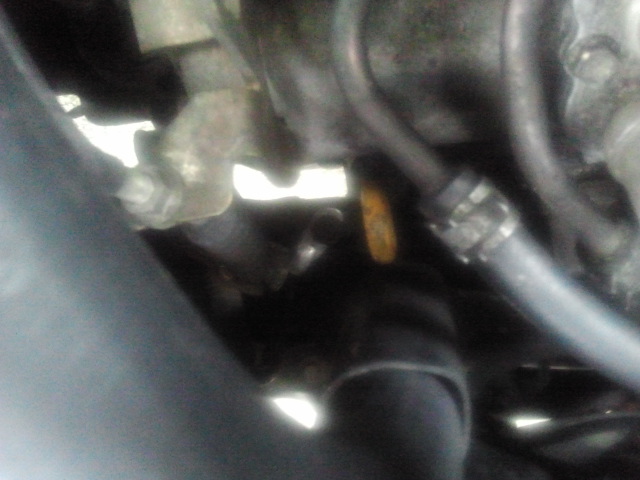

this is probly or most deffinatly not it, but if u have stock ground cable, u will need a new one. they do this super crappy fray thing where they bolt to the tranny. super bad. i got a terminal that bolts to, well the terminal, it has a stud with a wing nut, easy to remove wires that way, my ground has two female ends, and i soldered copper female end on to the positive wires. easy removal and installation. i used to have a electric smell when i stepped on it, now its gone. not sure what did it, but i have repaired quit a few things on my 92 ex. it may not totally sole this issue, but it will b a big step in the right direction

I can't thank you enough for the replies and pics!, I will check the exaust and replace the grounding wire as per B.G.'s instructions, in the morning. Again thanks and I will keep you posted.
