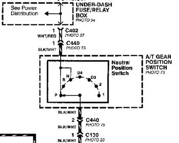

I just finished my H swap in my 94. I also swapped in a manual tranny. I need to know how to bypass the starter so vehicle can start. I was told it was where the old auto shifter was. If anyone has done this on their car let me know thanks

Where the old auto shifter postion switch was there should have been a connector with 2 BLACK/white wires going to it. Jumper that plug to put through to the starter solenoid.
Or better yet go ahead and route the wires to the Clutch SAFETY SWITCH.
You'll be ahead of the game if you down load the manual then you can also have the wiring diagrams for the back up lights too.

Are those 2 wire relatively thick. I will just run those to a kill switch. And the clutch pedal has 2 switches. If I were to run to the pedal which switch would I use. thanks for the help I got the reverse lights taken care of already
