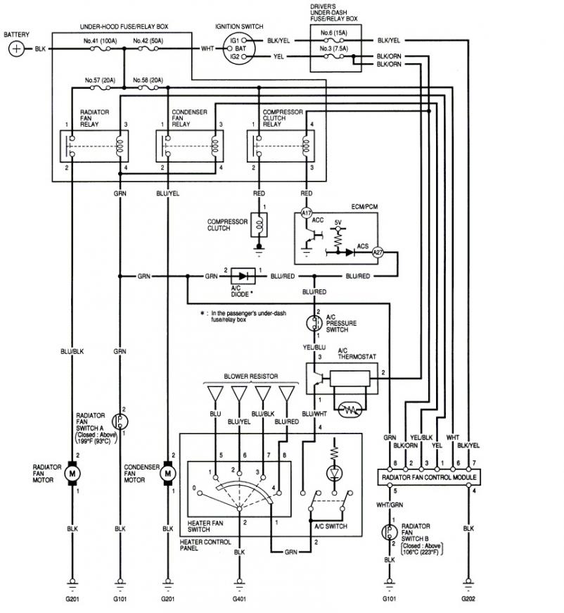

When you turn on the A/C switch, you ground a wire to activate your a/c. Somewhere your wire is grounded at all times before the pressure switch.
If your setup is similar to my 95, then the only two components downstream from the pressure switch are the thermostat, a stuck a/c switch on your console, or a grounded wire.
The Online Manuals link the DIY section have a 98-02 accord shop manual that will help. Use a continuity setting on a volt meter to ensure that the wire is grounded. Verify that one of the wires is grounded at the pressure switch (blu/yel on my accord your may be different).
Unplug a/c switch and see if wire is grounded (or start car and see if a/c turns on immediately). Do the same at the thermostat (on top evaporator in my car).

The hot side of the a/c switch is the blu/wht wire. If you have the control unit removed, see if that wire is grounded with the a/c switch unplugged. The ground label is G401 and the green wire goes to that. It is under the center console. See if that ground is loose or there is corrosion on it. I put some pics of what I am talking about below.

Test the two leads on the a/c switch that correspond to blu/wht and the green wire.
The circuit on the switch should be open when switch is off and closed when the switch is closed.

Thanks for the link- it worked great! I took the HCU apart and the switch works with my meter, but I can't figure out which leads on the HCU connector corespond with them... I spent about 4 hour messing around with it tonight. What I found was kinda wierd! With the connectors plugged into the back of the HCU(heater control unit) and the key on, I get 2.2volts on the YEL/GRN wire which is the "A/C on output" lead. when you turn on the fan and push in the a/c button it jumps up to 3.9 volts. Now heres where it gets wierd- if you unplug the HCU you get 4.4 volts on the YEL/GRN wire with the key on! I followed this all the way thru the a/c press. sw. and back to the PCM BLU/RED wire! WTF! Does the PCM send a signal to the A/C on switch? I am using a Fluke 32 and I am very confident of my readings. I thought the signal went FROM the HCU through the A/C pres. sw. then to the PCM.
