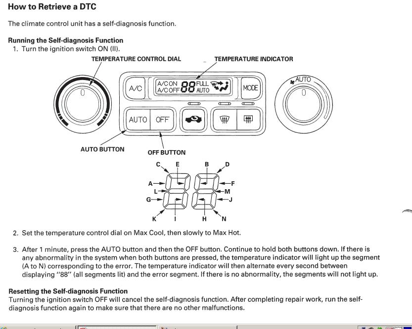

Again, I would try to get the codes. For the auto HVAC try this
Attached Thumbnails A/C Just Quit - Think It Is Electrical-6th-gen-hvac-auto-dtc.jpg
This is interesting. Thank you so much - didn't know there was such a self-diagnostic built into it. After reading the instructions, I did a search for the codes corresponding to each of the segments, and have yet to locate them. Would you possibly have a link to the code definitions?
Thanks, again, to all that have replied. Once I actually fix this, will post my findings.

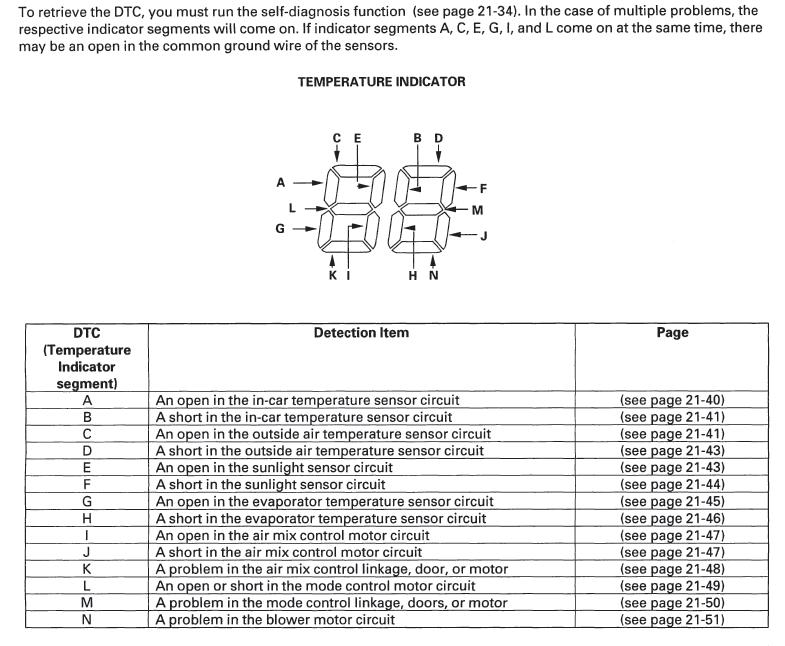

Prob still going to be something in the blower system but here you go
Attached Thumbnails A/C Just Quit - Think It Is Electrical-6th-gen-hvac-auto-dtc-codes.jpg

I FINALLY had time to work on my accord today. Ran the climate control self diagnostics with result "N", a problem in the blower motor circuit. Pulled the blower motor resistor, put an ohm meter across the contacts in all possible combinations, and had an open circuit on all. Called around and found, to my surprise, that not only was the honda dealership the only one with the resistor in stock, but they were less expensive than the other parts stores by as much as $25! (dealer price was $56.33 + tax) Put the new one in, and the system works like new!
