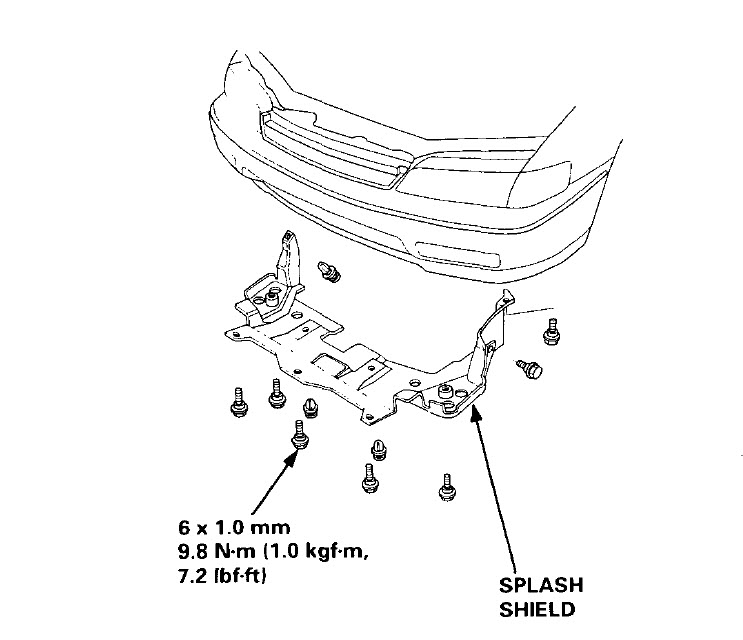

I was wondering if anyone here with a 94 - 97 Accord EX could take a picture or pictures of there front splash shield the one covering the under part of the engine so no water or mud can get in. Mine doesnt have one and i dont even know where or how many bolts or clips i would need. I nedd to know where it would mount to. I already went to the car junk yard but havent been able to find an accord with one on.. If anyone can help me out it would be greatly appreciated. Thnx
Old Dec 22, 2010 | 08:55 PM
It uses 7 bolts and 3 clips. Sometimes the clips break and people don't put all the clips back; only the one on the passenger side is more crucial though, so it doesn't hang.
Rock Auto has one left right now, for $24.98. Rock Auto part number: HO1228120 Honda OEM part number: 74111-SV1-A00
It is under engine, engine cover.
Attached Thumbnails Can Some One Help/ Do A Favor ? Please. Need a picture of 94 - 97 Accord Ex-splash-shield.jpg

Thanks Alot For This Pic ...And Info.. Do The Wheel Wells Have To be installed for the engine splash shield to fit..? My Car Doesnt Have Any
Old Dec 23, 2010 | 12:43 AM
No. They are separate pieces. A lot of times the engine splash shield needs to be removed for different repairs; but, the inner fender covers stay in place.
You can also purchase the inner fender liners from Rock Auto too. I think they are like $8 or so.
