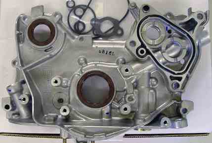

Here is the oil pump assemblyfor a 00 Accord 4 cyl.:

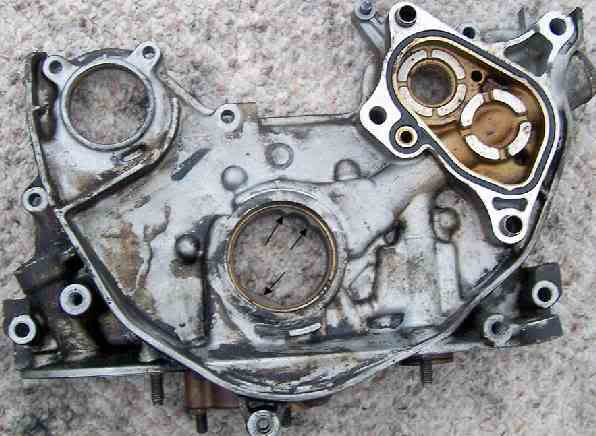

Here's one from a 92 that has had the crank seal removed (notice the provisions in the oil pump gear with which the crank must mate) :

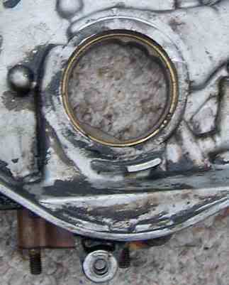

Closeup of the area that is normally obscured by the crank seal that better shows those provisions:
End of crank showing pulley area with keyway (red arrow), crank seal surface (black arrow), and oilpump surface with flat area to mate withoil pump gear (yellow):

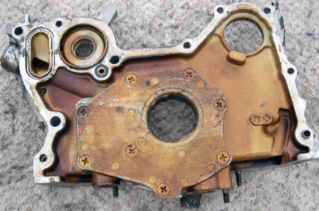

Back of the oil pump assembly showing plate over oil pump gear:

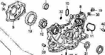

Exploded view of 92oil pump assembly showing oil gear (12), gear ring (13), and cover plate (9):

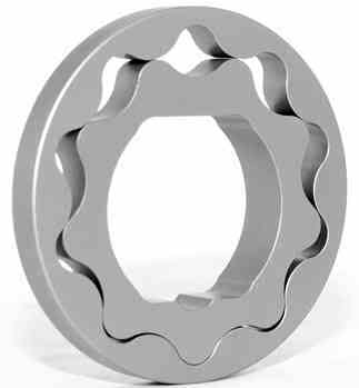

Photo of oil pump gears for Acura that are probably very similar to that of Accord:

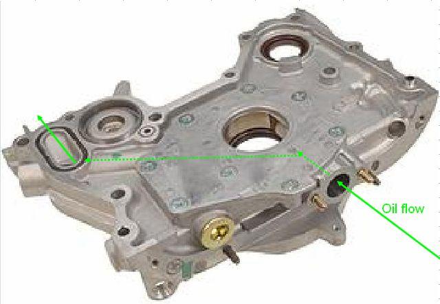

Direction of oil flow through oil pump assembly (I think):
By it's almost bullet-proof design, if the pan had adequate oil in it, and the pickup flowed freely, I very much doubt if replacing the belts, sealsand water pump would cause the oil distribution system to fail. That being said, however, I find it almost impossible to believe that the timing job and bearing failure are unrelated. That's far too much coincidence for me to swallow in one gulp.
Old Sep 22, 2007 | 02:45 PM
fakie99's Avatar
Joined: Sep 2007
Posts: 8
Default RE: Can Timing Belt Replacment Fry My Engine?
thanks for the pictures tony - that was a great help. i agree that it is too conincidental. but i am having a hard time figuring out theconnection between what the shop did and how it could have caused the oil pressure to go away?
