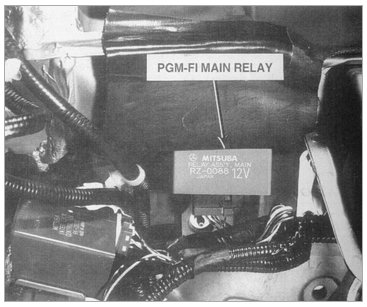

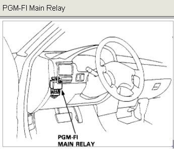

Operation: The main relay, actually contains two individual relays.
One relay is energized whenever the ignition is on, and it supplies the battery voltage to the ECM power to the injectors, and power to the second relay.
The second relay is energized for 2 seconds when the ignition is switched on before starting, and when the engine is running, to supply power to the fuel pump.

The common failure of those main relays is cracked solder joints on the printed circuit board inside the relay case. So many people fix them instead of buying a new relay.
Once the relay is out you can pop open it's case & re-melt the joints on the board. Or... lots of people are not comfortable with that kind of repair so they buy new relays.
Does the pump run for 2 seconds even on the occasions when it doesn't start?? Often, the relay fails when the interior of the car is hot, then you open the doors & windows, call for help, hang out for awhile, THEN the interior has cooled down and the engine starts right up...
So if it's not the main relay, then you're back to figuring out lack-of-fuel vs. lack-of-spark.
