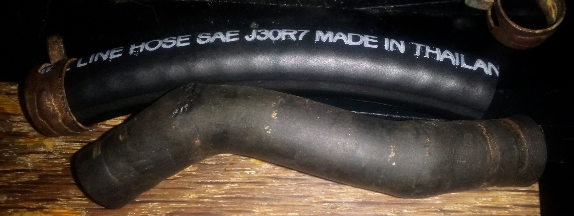

You were right. I found the coolant leak. I wasn't able to find any adapter whatsoever to fit and seal over that radiator cap. But I was able to look under the car near the transmission. Took my glove and swipe the leak and notice the leak was the color green. Then I looked on top of the car and noticed a very small hose bubbling. Two clamps (there seems some kind of crack due to corrosion near the clamp). I should be able to replace it according to the parts store hopefully.

What small hose is leaking? Where does it attach at the radiator and where does the other end attach? Maybe post a picture, because I'm not sure what is leaking.
This one, I replaced it 2 weeks ago. Then added coolant. And the car doesn't seem to be over heating anymore. So I got this problem resolved. It didn't look like it was a coolant hose at first. But after close examination, it comes up from a bigger coolant hose.
