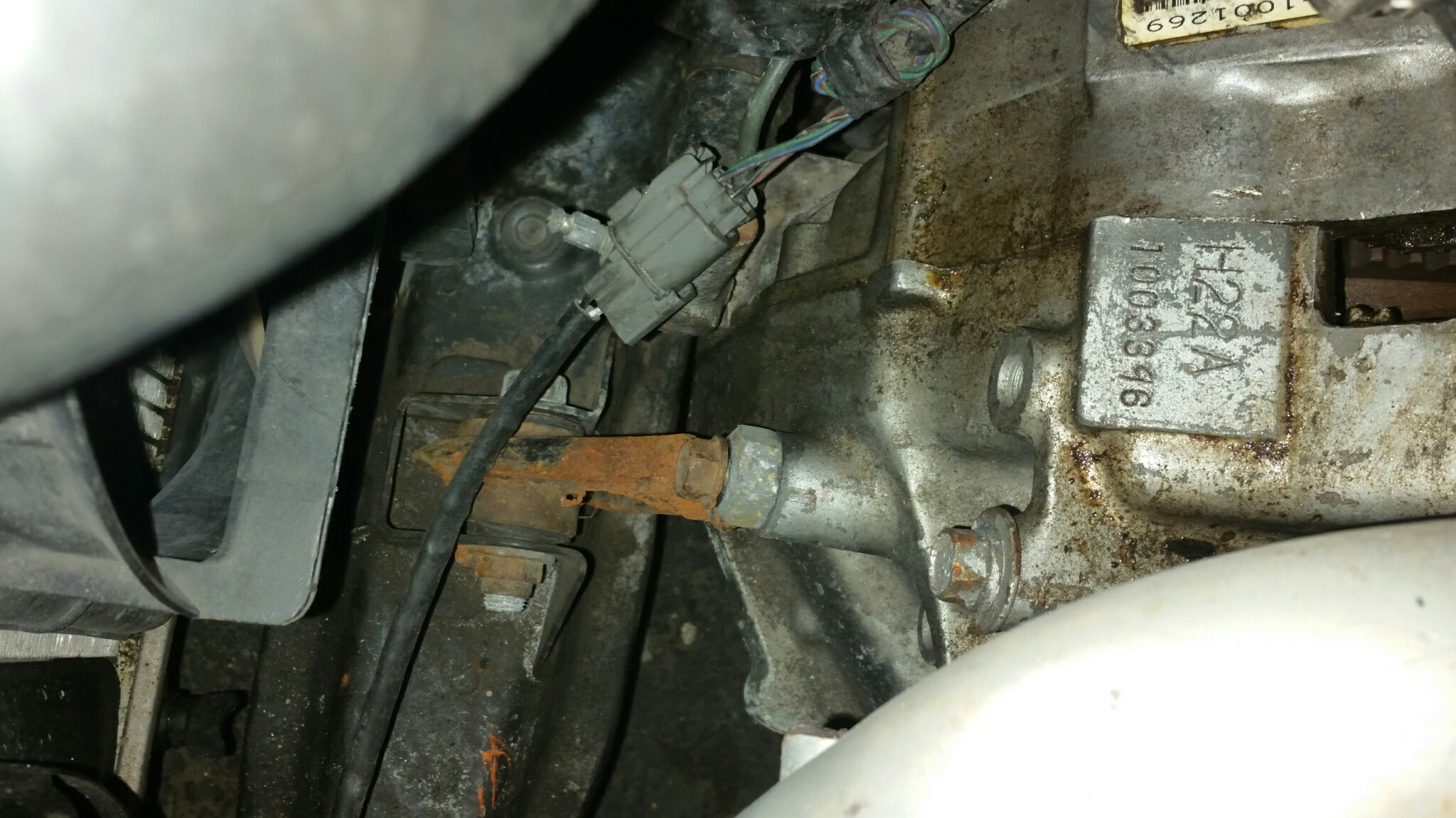

This engine has the manual tensioner conversion which looks like it was done right except for where the spring attaches to from the deadbolt in the block to the pulleys flat shim. "See picture"
IIRC this engine has the spring connected to the long "beam shaped bore " versus the smaller hole below it.
Any thoughts about the tensioner? Clutch solution? Do timing waterpump as well?
Should all of this work be done all at once for example "because im down there? I think I do most of the timing stuff in the car as I was down there recently but i would think the mount would have to be removed more or less

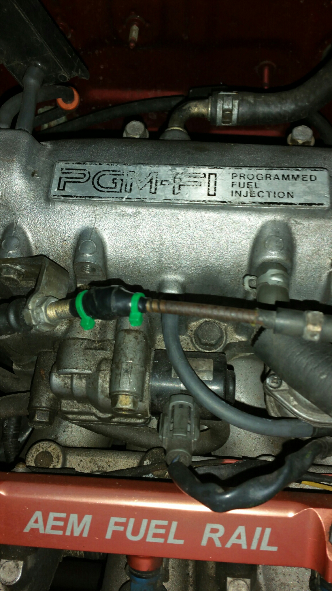

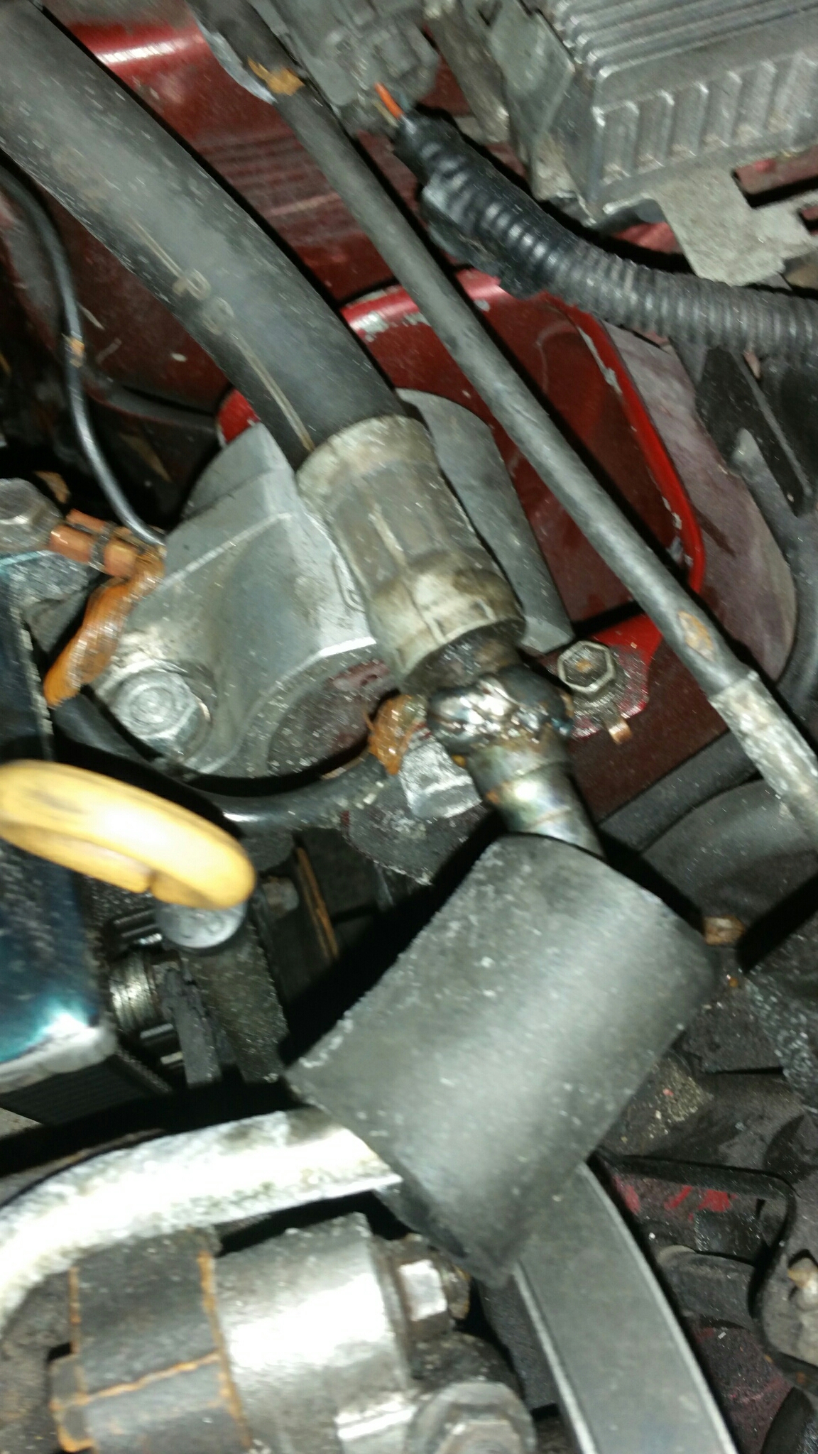

Pictures of other concerns on the car

The spring is installed correctly. That slot is to install a bolt to hold the tensioner in place. I'd do the water pump too. If that pump seizes up, then you will break the belt. It is cheap insurance to install a new water pump.
I'd do the whole clutch job at the same time, because it is only a few more steps to install the clutch and flywheel when you are in there.

So the tensioner pictured is correct? Because the spring on my engine goes from block dead bolt to the curved oval shape.
Sweet. I may if i get clutch flywheel by mid next week it can go in by weekend

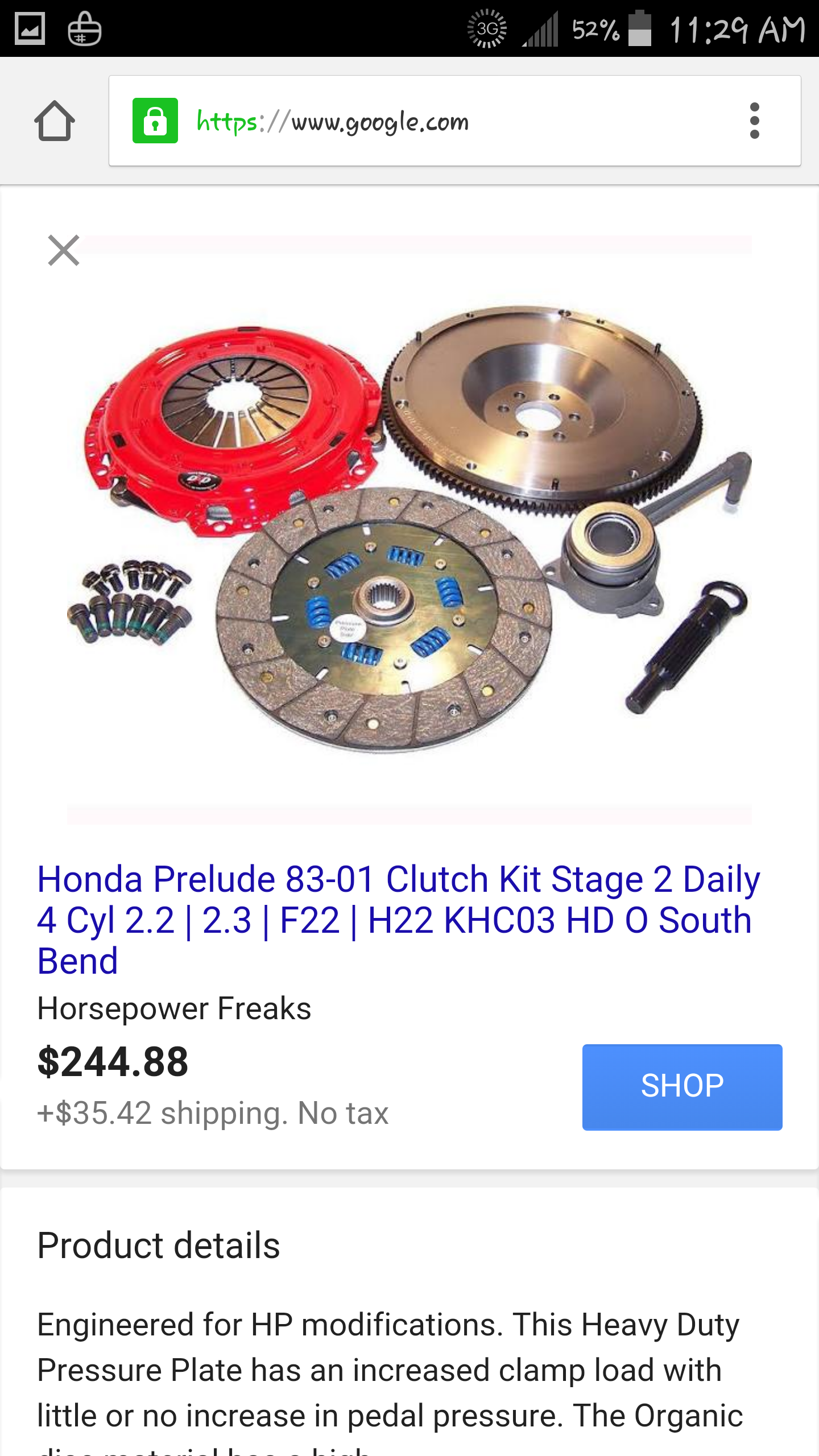

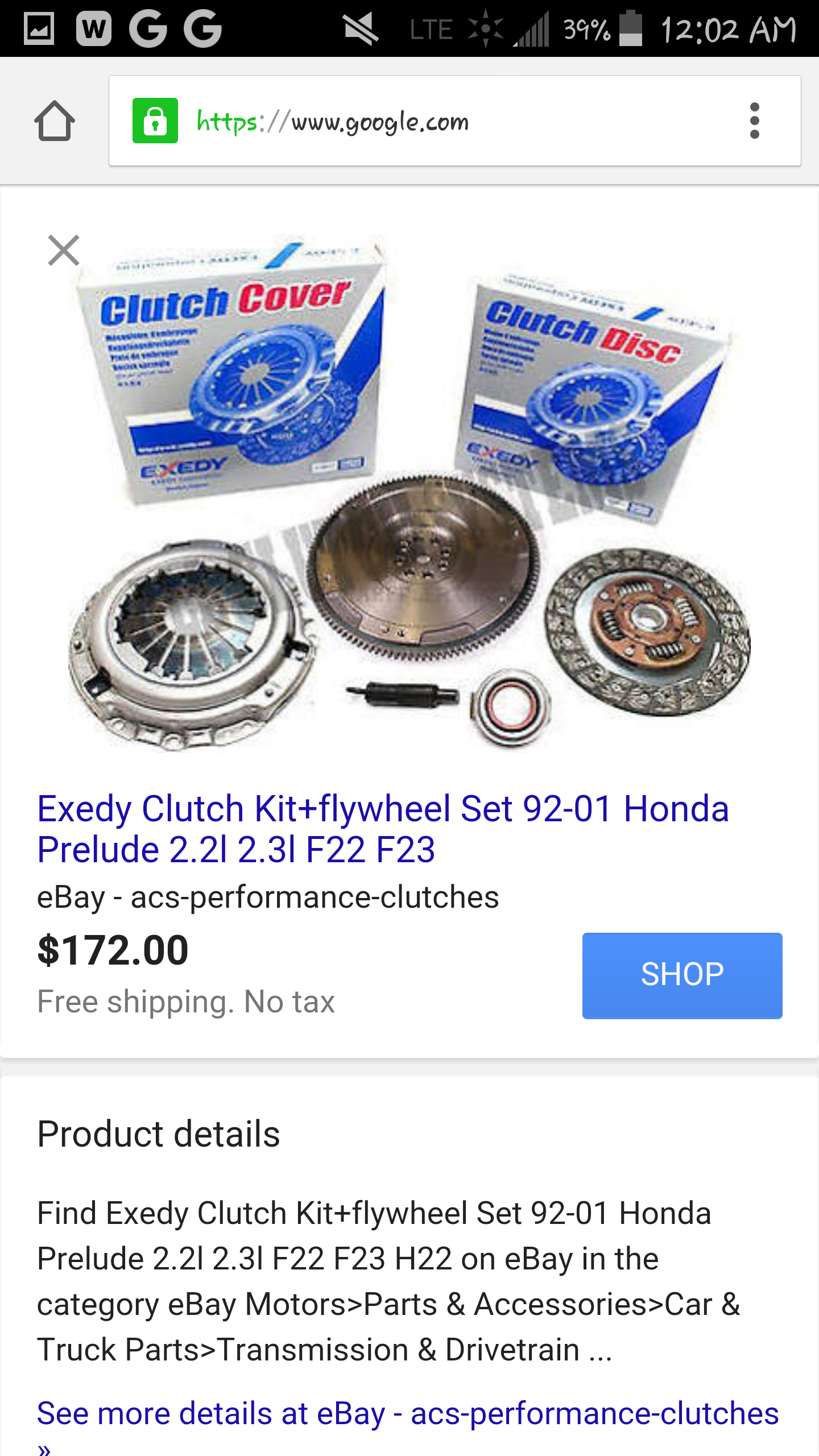

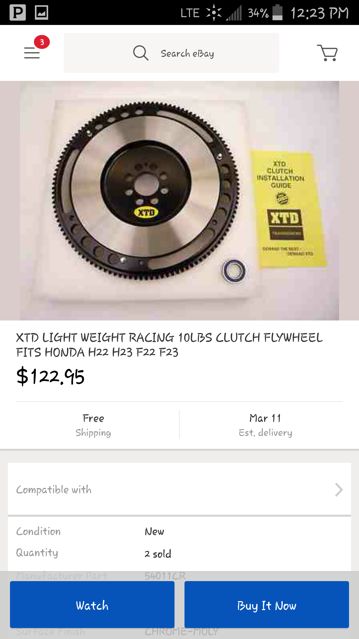

I figure because I do mostly daily driving with occasional/seldom pulls past 6k
Is this my best bet? Reputable brand and flywheel included?amazing price.
What should I do. I like to budget build but refuse to purchase inferior mechanical parts
