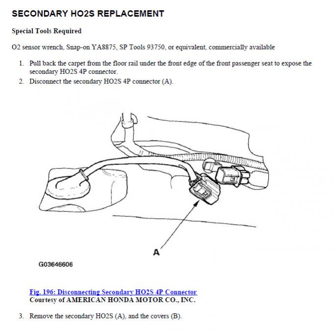

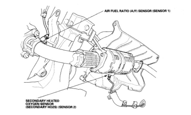

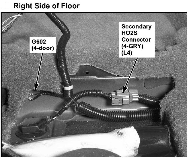

Post the actual trouble code on this forum. Yes, for the 4 cylinder there is a air/fuel ratio sensor (a type of wide-band O2 sensor) and the secondary heated oxygen sensor.
Before even replacing the sensor, there may be fuse(s) to check, etc.
If it is the rear O2 sensor here are some info. (attached pics) and a link.
Note: Always work under a safely supported car, for example, using jack stands to support car and not just a jack to hold up the car. Your health and safety is more important than trying to save some money.
To disconnect the plastic electrical connector inside the car, slide the connectors off a tab bracket on the car chassis before attempting to disconnect the two ends of the connectors. Otherwise, you will have a really tough time trying to disconnect the two ends of the connectors. (In this link, the guy didn't know about sliding the connector off the bracket first.)
https://sites.google.com/site/hondar...-oxygen-sensor
Attached Thumbnails CEL Comes on Sporadically-2003-2007-accord-l4-af-sensor-o2-sensor.jpg   CEL Comes on Sporadically-2003-2007-accord-4-cylinder-rear-o2-connector.jpg   CEL Comes on Sporadically-secondary-o2-sensor-replacement.jpg
