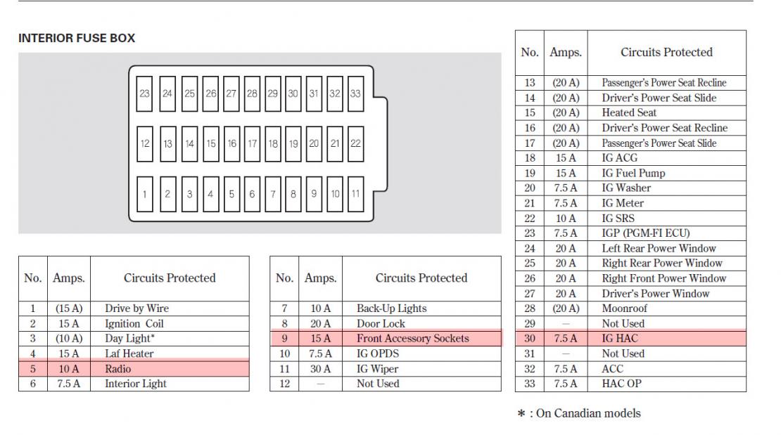

I have Mom's '03 and the fan on AC stopped. No owners manual, where is the fuse that controls interior fan?
After fooling around pulling and replacing fuses my radio and power adapter aka cigarette lighter don't work.
Please help.

you have two fuse boxes,1 under the hood passenger side up by firewall,2nd driver side bottom by left foot kick panel

An '03 and the blower stopped, I'd be worried about the transistor as well.
Also there is a relay involved here.
For more info on the location of these, does this car have climate control?

Like two other members already stated, probably a problem with the blower motor power transistor. The blower power transistor controls the blower motor in all speeds except HIGH, try turning it to HIGH and see if it works.
Here are a couple of threads regarding repairing, or just the location of it for replacement.
For the fuse(s) to check for the blower motor, radio, and front accessory socket, see attached pics.
How to fix AC (Blower) transistor module - HondaSUV Forums - Discussion forum and bulletin board for Honda CR-V, CRV, Element, Pilot, HR-V owners
https://www.hondaaccordforum.com/for...-repair-40796/
