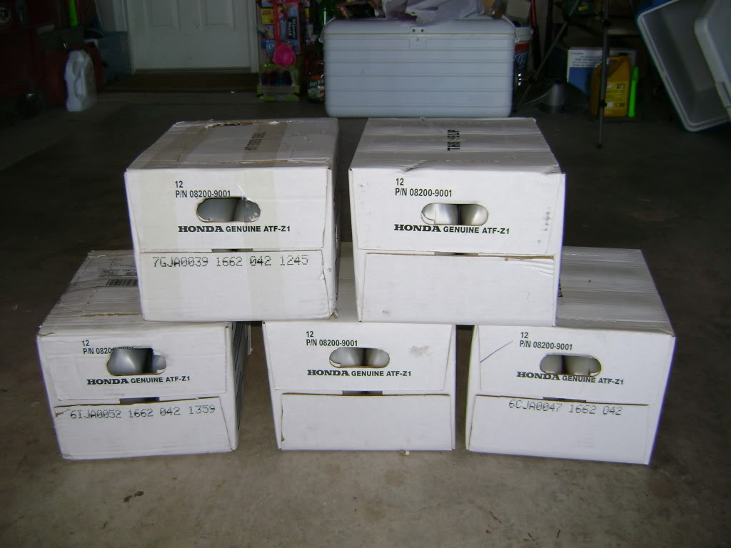

Fifth drain-refill, and finally the waste ATF was red with none of the black silt in the drain pan, and a very, very light coating of material on the drain plug magnet. Filled it with ATF-Z1 this time (I have a couple cases of it from the good old days when it was cheap online at Maximum Auto Parts). Will do 3 more drain refills with the ATF-Z1 over the course of next week. It shifts a little smoother now, but again, it was shifting fine before I did this. I can say that if it didn't make that light, annoying thump upon shifting into reverse on freezing cold days, I don't think I would have drained the ATF in the first place.
I don't think the little old lady who owned it ever, ever, ever had the Honda dealer drain & refill the ATF. Over 174,000 miles, probably with minimal topping off, if at all. Yikes. I've only got about 2,000 miles or so on it since I installed the Magnefine in the rubber line leading to the Hayden ATF cooler, but I'll bet that inline filter is clogged. I'll probably change it during the course of the next 2 or 3 drain-refills with ATF-Z1.
