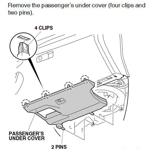

Trying to change the blower transistor on 16 Accord. Transistor is located under dash and behind/left of blower motor. What has to be removed in order to reach it. Thanks.
Old Oct 27, 2017 | 04:50 PM
Remove the passenger undercover first.
Attached Thumbnails Changing blower transistor on 2016 Accord-under-cover.jpg

Thanks, I removed that cover, tried to remove a few things under there and is real difficult to which to remove in order to finally be able to remove the existing transistor. Appreciate your pointers, ver tight space under, making dizzy!

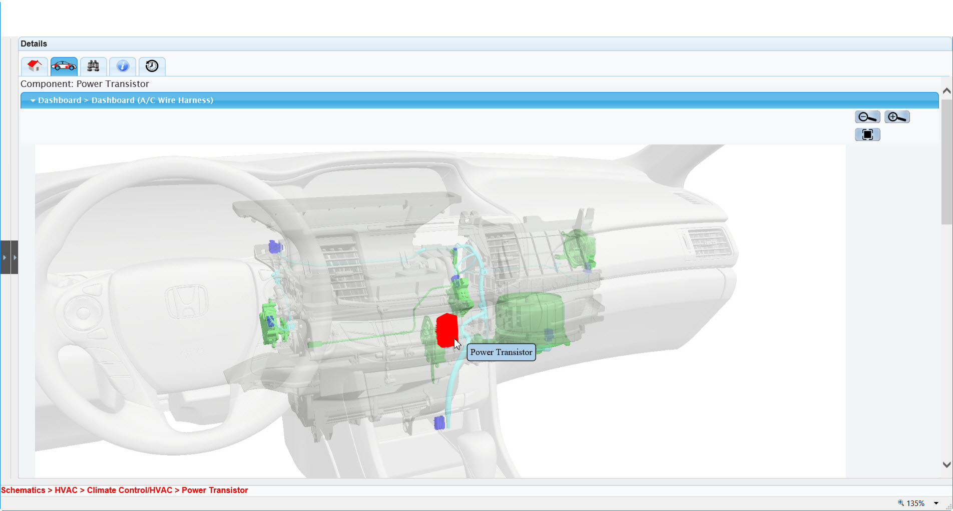

You can remove the glove box. This link has a video on glove box removal:
The attached image is the location of the power transistor.
Attached Thumbnails Changing blower transistor on 2016 Accord-power-transistor.jpg

That is perfect, thank you for the image and the video, you are a real champ. I am on it in the morning. Game 3 tonight, thanks again.
