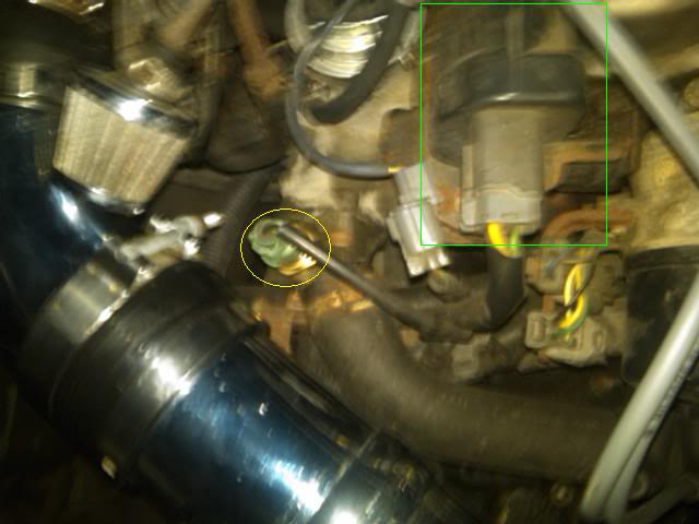

the "yellow" circle is the switch, and the green is the coil, the stock air box may be in your way.... please note this is on my 97

got around to remove the coolant switch ... it has a pointed end not a flat. Did I remove the wrong one? Switch A is the one behind/underneath the distributor cap correct?

how about the coolant switch? I got the original one out yesterday and it had a pointed end not flat. did I remove the incorrect one?

im pretty sure not 100% that what you removed was the temp sensor, the part can be different between years, but the picture shown for the switch you ordered has a flat end. the diagram i posted above is for you year car, if you look at it it shows the location to the bleeder. directly to the left you see the part which has the wire harness connected to it sticking straight up, 11-12o'clock position, that should be the switch. it should be in a similar spot as the pic of my engine above, i have a cold air intake on my car so the stock air box setup isnt covering it, you might have to take the stock air tubes off to get to the switch, but not sure
